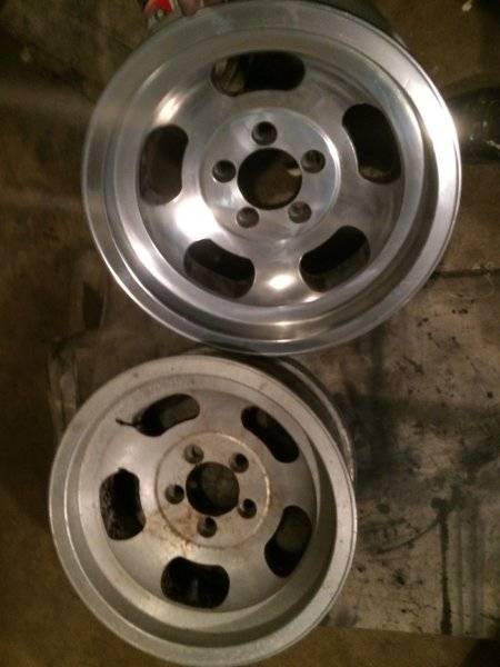

I am taking the time to restore a set of aluminum slots for my roadrunner.
Between sanding, wet sanding, polishing, taping and painting the inserts..
well they are taking a decent effort to get done.
They are looking like a million bucks now, but I am concerned that if I don't clear coat them, they may re oxidize over time.
Question I have is how long will they look great before they go down hill.
Car would be a summer driver.

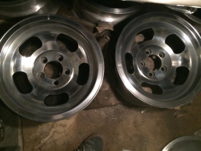

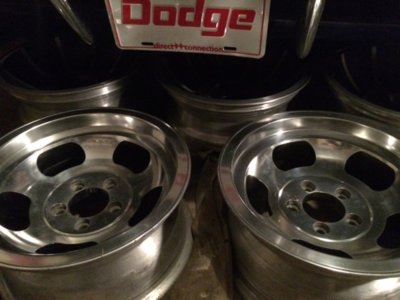

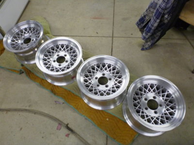

Finished out these in a 600 wet sand.
Then used mothers on a powerball/drill to final polish.

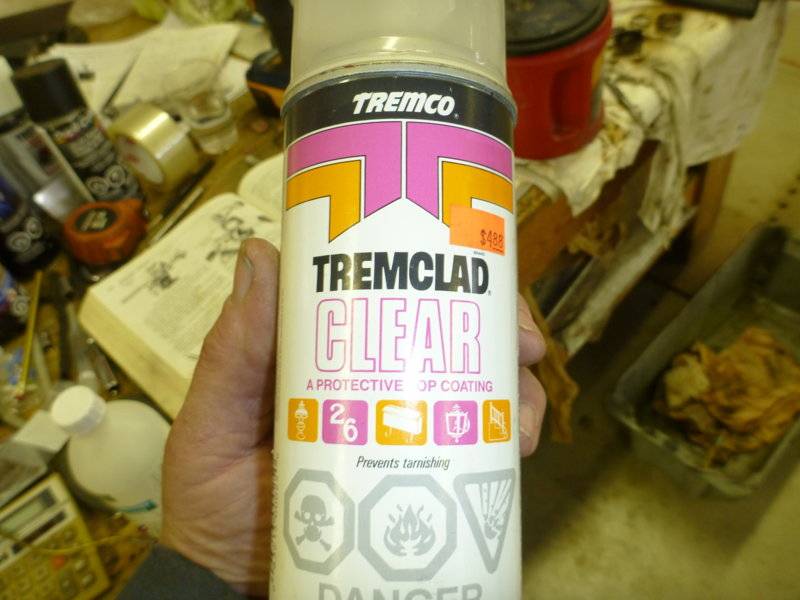

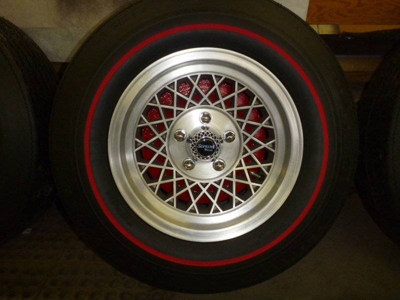

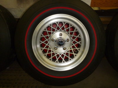

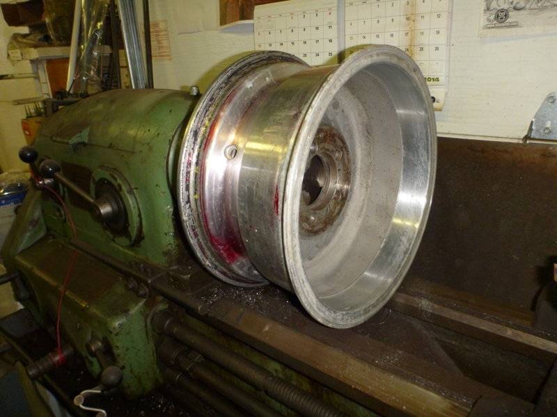

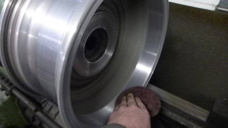

Nice, I was up to 2000 with mine to clean them up (that I originally bought in '79! and have never really cleaned correctly) and then cleared them with Tremclad clear "anti-tarnish".

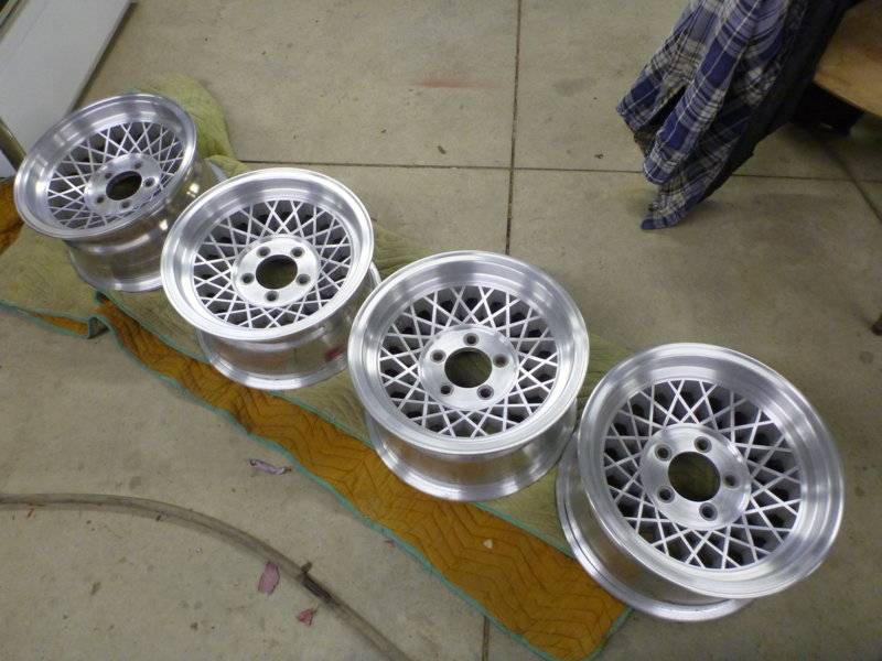

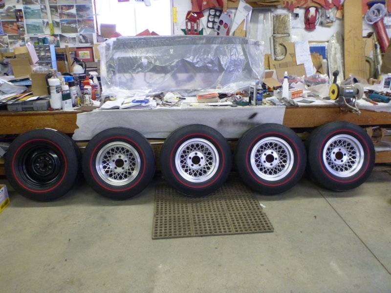

beerestoration2015-2016 1925.JPG beerestoration2017 655.JPG beerestoration2017 656.JPG beerestoration2017 657.JPG beerestoration2017 669.JPG beerestoration2017 677.JPG beerestoration2017 805.JPG beerestoration2017 811.JPG

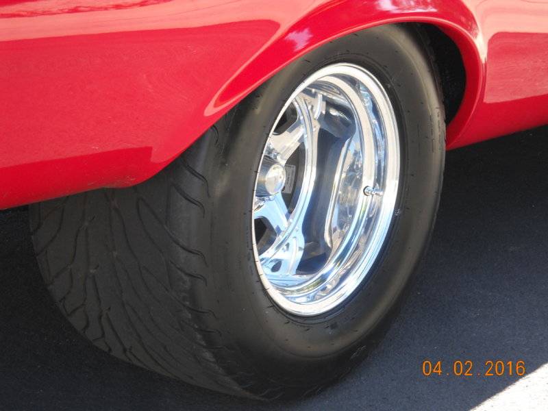

I polish my wheels with mothers than I apply 3 coats of a good car wax such as meguiars Gold Class.
