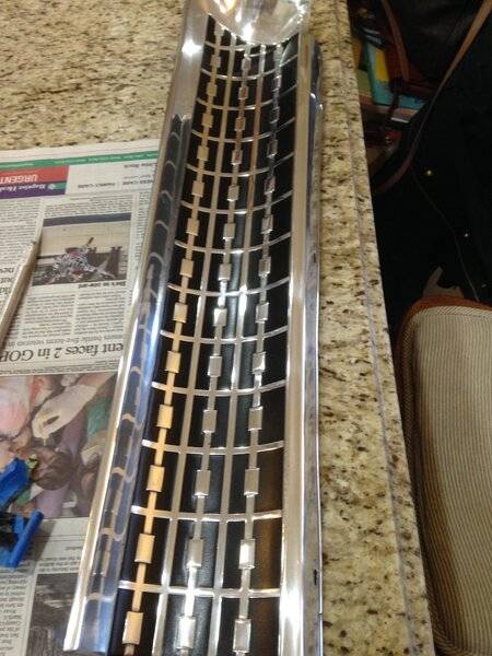

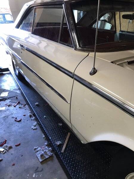

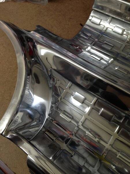

A little off topic but since Mopars use a lot of aluminum. . . . I did all the aluminum and SS inside and out on a 427, 63 Galaxie. Took me quite awhile as I had not worked with aluminum before but this car belonged to a good friend. And a 63 Galaxie has a lot of trim. A lot of it is thin and soft to where it picks up pits from road rash. And a lot of the interior aluminum window surrounds was extremely pitted. The only thing we could figure was it was a corrosive effect from tobacco smoke and moisture. A lot of that pitting can’t be removed as it’s too deep and removal would destroy the contours of the surface and in some cases endanger going clear through the metal. And dent and crease removal took more care than with SS as it was to easy to move the metal too much. I actually hound pop cycle sticks whittled to various points worked well on aluminum in many cases. All in all, I can do aluminum but think I would rather do SS.
I will admit, I’ve screwed up some pieces thinking “I can fix it” or “ what hell, I’ll give it a shot”! Pitted aluminum is hard to fix, but if it’s a thicker piece, my sander gets a work out!

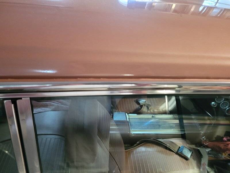

I polished all the exterior stainless trim on my 67 and it turned out really nice. I was fortunate that my trim was straight and dent-free though it did have some bad scratches, mostly from me not storing it properly when I took it off the car. Yes, it was a lot of work - I bet I spent at least 100 hrs on it, but I didn't think it was particularly difficult. I was a lot younger so it would take me longer now I'm sure lol.
I bought a buffing setup from Eastwood and converted my bench grinder cause I didn't know of any other option, certainly not that I could afford, but to do it myself.
I took the car to a judged Mopar show run by a local club not long after I got it back together and the trim judge complimented me on the how good it looked so I guess I did ok.

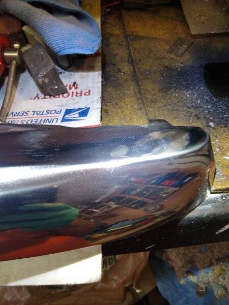

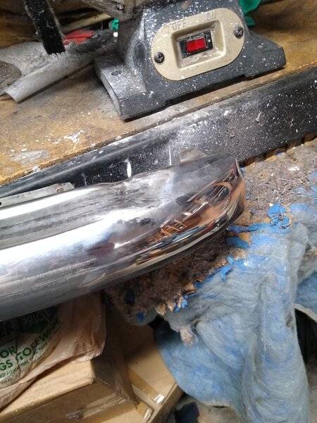

This is a before and after of the stainless trim over the windshield for a Chrysler TC. The first shows the damage from the convertible top hooks smacking into it and weatherstrip rubbing over the years. Just out of curiosity I got a buffing wheel that I put on my bench grinder to try my hand at polishing trim. A little hammer and dolly work on the dent followed by sanding and polishing and this is the result. It's a learning curve for sure, and I do admit to having parts flying across the garage more than once! It may not be 'show quality' but I'm pretty pleased with it and proud to say I did it myself:thumbsup:
