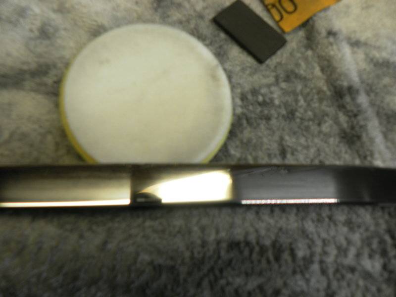

What cudachick says, I bet you are not getting the deep scratches out, and they will continue to show until you get good even sanding at the coarser grits and work your way up. I know because I went round and round with the stainless trim piece on my windshield, and I found that I was not going long enough sanding at the coarse grits, but when I thought I was done at one level, I sanded some more, and then when I thought I was done, I sanded some more, it takes some time, but if you get that then the rest will come to be much better result.
This was my end result I spent maybe 40 hours on this, its a large piece.
