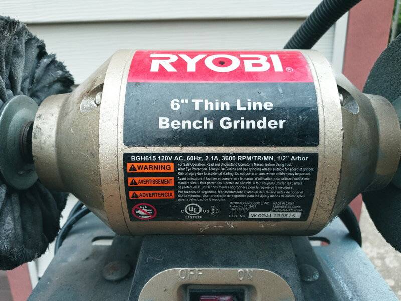

I guess I'm going to be polishing some stainless trim soon, new task for me. I know there are various threads on our site. Can anyone recommend any good sources for doing it properly, maybe with some tutorial video ?
I have NO experience at this, as I'm more of a "rough carpenter", or wood butcher. This popped up locally yesterday, so I picked it up...
