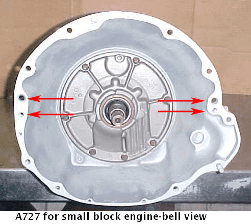

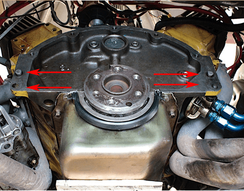

      I have a '65, and had the cable shift transmission. I swapped it for a 1970 727 TF from an E body. It was exactly the same length, and Schumaker makes a conversion trans mount for the swap. there aren't a whole lot of choices for the Poly head, but it's unique if you pursue that route.
      There will be one bolt hole on the engine that doesn't line up with the later transmission. You can see the later 727 below left, the hole above the locating pin on the driver's side is closer to the pin, and on the Poly block they are symmetrical. We ended up drilling a hole on the driver's side of the block above the locating pin to run a bolt through it, it's where the starter is, but I never really had any issues before I drilled that hole. We did it when I swapped to a 4L60e transmission.

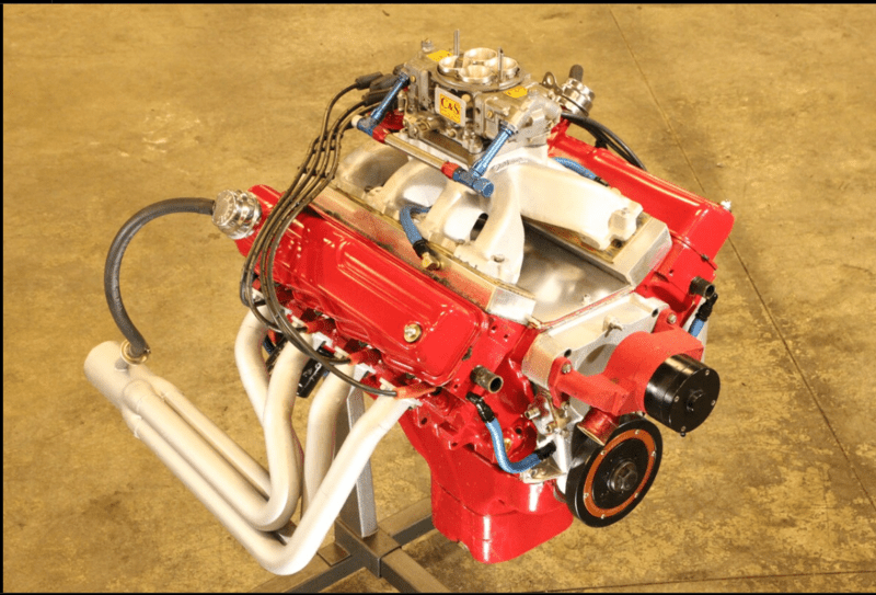

            2.02 exh & 1.60 int valves are an easy change and really let it breath. The machinist I used didn't charge me any more than the standard valve job price...said, "I have to cut them either way...I don't care what size the hole is." Original cam can be reground for half what it costs for a new one. Schneider Cams did mine. Gary Pavlovichc is a great source of knowledge and parts for the Poly. Do a search (on this site and the web) of his name.
            Good luck. Polys unite!

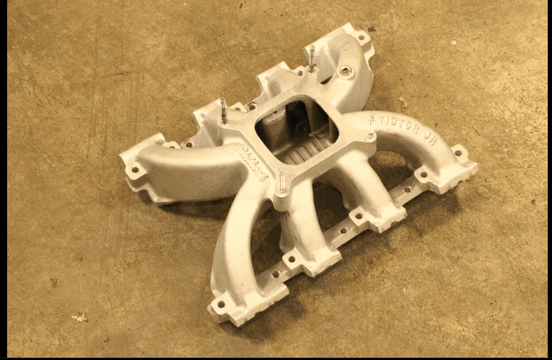

                the poly block has thicker walls, which is awesome for durability and even better for stroking and boring. Piston selection is limited but custom pistons don't cost that much more. And yeah, intake prices are up there, BUT if you don't care about originality, an LS manifold has the exact same port spacing and bolt pattern. There is some port matching and a spacer that needs done for it to be perfect but it is a cheaper alternative. Ford small block headers have the same exhaust port spacing, just need poly flanges welded to them and some massaging to get them to fit a manual steer car. wont work for power steering. So the other option is 3rd gen hemi shortly headers/manifolds from a Jeep Grand Cherokee, but again, need poly flanges.
                Id go poly. Trust me, the WTF looks from "car guys" at car shows when you pop that hood and that wide ass 318 is in there is worth every penny.

                    An LS intake on a poly, holy smokes!
                    I gotta see that, not sure how bad I need to see it though.

                      you do need a spacer, but it will work

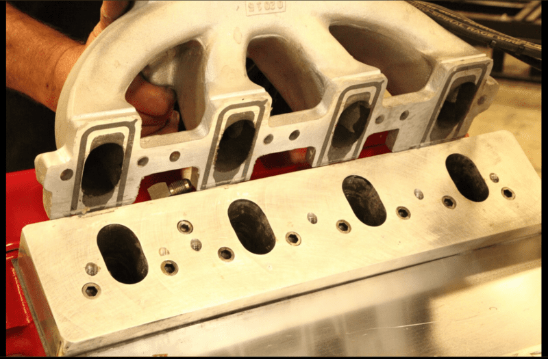

                      your wish is my command...
