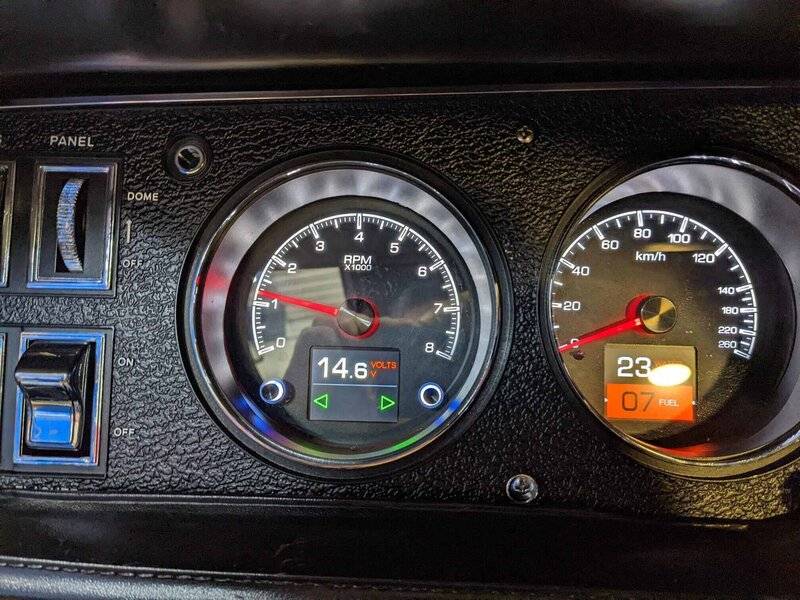

Thanks for all your replies.
Vac source is where it should be, triple checked that.
Pedal behaving normally as in, the pedal pulls down when I start the engine. The behaviour doesn't change once brakes are warm.
Idle set at around 2000-2300 rpm
I had this problem when I was on DOT 4 fluid, hence the change to DOT 5
I'm leaning towards cheap pad material
I guess that I will answer the obvious question. Why 2000-2500 RPM idle ? Normal cars 700-900 RPM.
Must be more to this story you haven't told us.
My apologies I meant 1,200 rpm. What was I thinking?!?
I could but that's not the issue at stake. At slow speeds on cold brakes I would rear end someone if I don't stand on the pedal.
Sorry but that most likely IS the issue at stake.
You are running the idle speed that high just to get 15" Hg. That 15" is a very minimum required for vacuum power brakes on a Mopar. Typically, you should be able to idle at 750-800 rpm and have around 18-20" Hg vacuum for proper factory brakes. To me that says you have too much cam for your factory power brakes. At that speed your carb is NOT operating on the fuel idle circuit. Almost certainly, you have the venturies partially open at that rpm.
I would guess that if you back the RPM down to a normal range of 750-800 your vacuum is most likely around 8-9" Hg? Way too low for vacuum power brakes. Too much cam IMHO.

So to summarize, it sounds like you have two issues with your brakes that add up to a lot of headaches. Good luck with your car, and yes the gauges are "cool".
Thanks for the info M&M, my bad for not explaining myself well.
Cold start (on choke it) idles at 1,200 rpm. Once warm, idle drops to 650-700 rpm. Vac of 15mmHg is at 700rpm idle.
