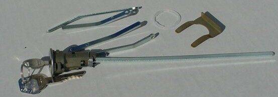

I would remove the rear seat back and divider and see of you can squish the end of a piece of conduit flat so that the bar for the lock will fit in it and then twist the conduit and open the lock without damaging anything. The flat bar below is what I'm talking about. Thats what needs to be twisted to unlock the trunk. All of this could have been avoided if you would have purchased the trunk monkey option.

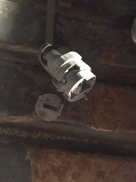

well.. crawling in worked easily enough to remove the bolts.. Thanks YY1.
lock looks shot though.

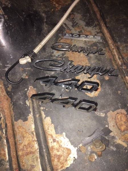

Did find some extra emblems, along with the trunk lid emblems.
