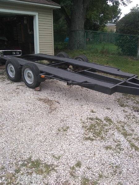

I bought a brand new used trailer last night.
