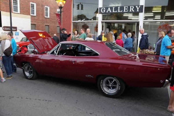

Looking to upgrade my 74RR. 15-17”. I’m looking to get a visual for ideas.
Dan is the one looking. Me, I've had similar combos on my cars for 50+ years.@WileE , if it’s old school you desire here you go, op idk if it’ll help on your car , but front - 15x7 , I don’t know what back space, 235/60 tires. Rear - 15x10, 4.5 bs, 275x60 tires
I like that.My set-up is:
Rears - 15 x 8 Welds with a 275-60-15 Tire.
Fronts - 15 x 3.5 Welds with a 27 tall x 4 Mickey Thompson ET street radial.
View attachment 1956504View attachment 1956505
I agree on 15’s but wanted to give myself more tire options so I included 16s and 17s. After seeing the 17s above I think that would be too much wheel. Peter Bergman and Bergmans auto told me the 73/74 b bodies could take up to 295’s no problem. I am looking to get as wide as I can in the back and probably a little narrower in the front. I wasn’t sure on profile. I do like the look of the 60 profile on @71Beeper above. I’ll wait to see if someone posts 50s.Don't ask me. I'm an old school fart. 15's in whatever style you like. Want proof ? ^^ The badass above !
