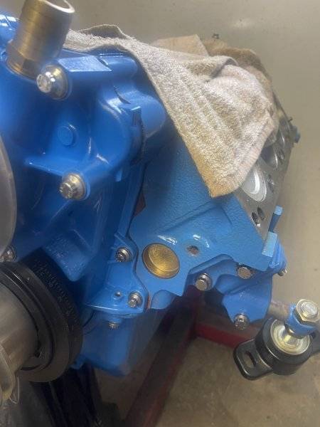

I had my block and heads powder coated. It looks great and is easy to keep clean. I did the block, head, and trans case on my SRT-4 done 12 years ago and they held up great as well

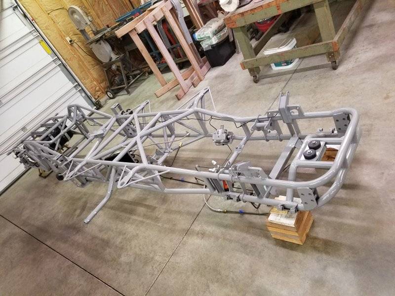

I have an entire frame powdercoated,
and don't expect it to look good as new
after driving it daily for ten years of
"normal" use. Please excuse me for
being sceptable.
