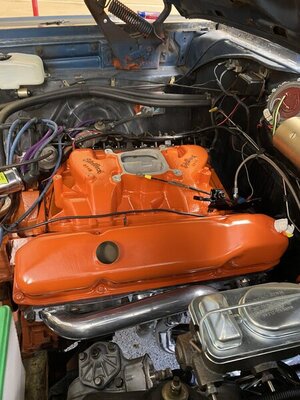

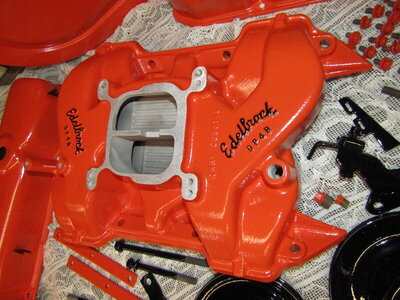

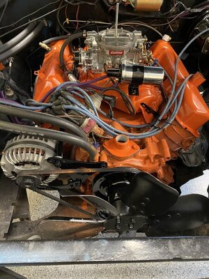

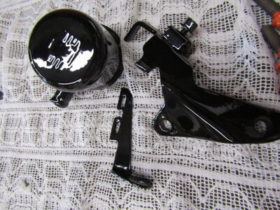

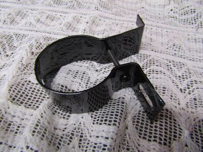

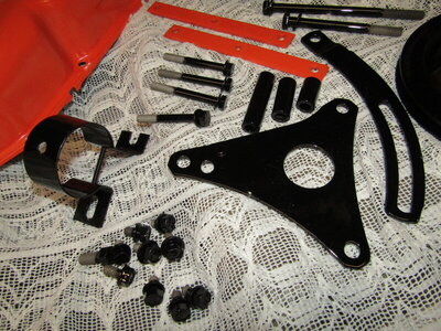

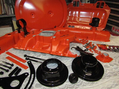

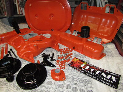

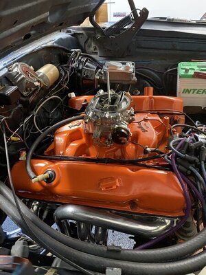

I want to give a big shout out to @CudaChick1968 for an awesome job on my engine parts.
BF9B4D04-2AC0-431D-B6B6-34A8995678B8.jpeg EC088BB2-FCE1-4074-A138-C5CE37FAC867.jpeg DCB495D0-339E-44E8-ABC5-6B9F421D03CC.jpeg 8A18E109-6F17-44E4-A259-4C2F9CB772B9.jpeg 31D96492-489F-4F6B-A377-098F0DA7E2AD.jpeg 8AE9BBFA-F7DC-4342-ACB3-61F86D350E83.jpeg 1CBF5F82-B438-4194-A60A-5B921761A0CD.jpeg F2F239D9-9CB2-4D06-83E2-1F37317BCF9F.jpeg FB7D0884-0F6F-4DDE-ACCB-7433BC0616E9.jpeg
Is that intake manifold aluminum? If so I assume its not powder coated right?
Doesn't that plastic powder melt at like 400*F? I was doing it in an old electric range oven.
Mike
More like 600 F. I think 1200 is if you want to burn it off !!
But they don't heat powdercoat to that temp so nothing to worry about. But I re-read all the posts and see your point - in response to a previous post.
Never thought about powder on the engine parts. That looks great.
Wow Anthony, you gave me an early birthday present today for sure! Thank you for showing it off and for the sweet compliment!
Just quickly addressing a couple comments, everything I restore here is powder coated.
Yes, these powders flow out and cure between 300-400 degrees. There are powders now for low temp applications these days too including wood, MDF and even a portable system for pool liners that cures in sunlight.
There is nothing to worry about as far as metal temper or tolerances go if you know what you're doing. Aluminum is in fact my favorite metal to work up, especially cast parts.
For the job to last a lifetime the metal must be properly prepared. I use media blasting and several other steps to ensure fantastic results and durable adhesion. On the intake gasket I only blasted the recess, not the flanges or underside, though I coated the entire top side for two reasons; it shows a bit between the heads and intake flanges, and any raw / uncoated metal subject to the elements will oxidize over time if it isn't protected. No powder is on any internal engine surface.
