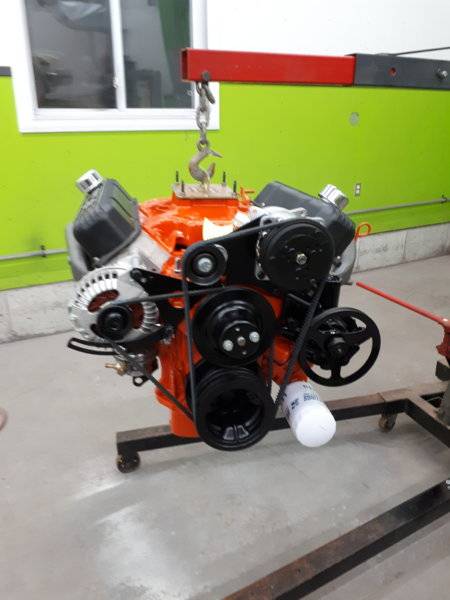

Does anyone know the correct size power steering belt. It's a 1969 440. Without factory air conditioning. The belt will route from the power steering to the crank pulley. Napa gave me a 44 inch belt, but much too long.
What is that power steering pump out of? Looks like a big pulley.
The parts catalogs show 42.5” for 69 Coronet 440.
Not sure on length but my 1968 uses a slightly larger section belt on the power steering.
