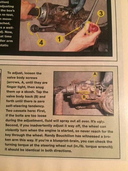

It depends. I'll post an article from Mopar Action about it. Hold on.
Aeronets Post#2 pay attention to it. You can be seriously injured if wheel whips around.
I had to do it a couple of years ago when I replaced the steering gear. The wheel turned to the right a little bit on start up.
It's a delicate operation.
I take you're not familiar with the "skosh chart" by Richard Ehrenberg.
You can see it on Allpar. It's about alignment specs for older cars that were originally equiped with bias ply tires but now sport radials.
Now I had to google skosh. Its an actual word. Not just something my mom would say to us kids when she needed more room. "Honey could you move over a skosh"
