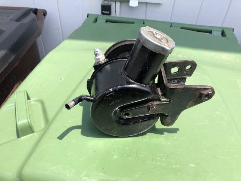

Hi All, I could use some help troubleshooting.
1968 Charger, 440 with what looks to be a TRW pump. I have the Tallon hydroboost setup as well, so high pressure out of p/s pump into brake booster, then high pressure from brake booster to p/s gear box.
Up until a few weeks ago everything was fine. Then I started to notice at startup when idling there wasn't much power to the steering, but once I got it moving even a little bit things seemed back to normal. Takes 5-15 seconds to clear up. No issues with the brakes until today.
Fired up this morning just fine, again a little struggle with power steering just until I got out of the driveway then everything was fine. Parked at our local cars & coffee event and hung out for an hour to 90 mins.
Leaving the event, no power steering at all. I pulled out thinking it was the typical slow to get power to the steering issue, but then the steering didn't return and now no power assist to the brakes.
I pulled over and opened the p/s reservoir and the level was exactly where I'd expect it to be, but I didn't see any fluid moving. Checked over all the lines and no drips or leaks.

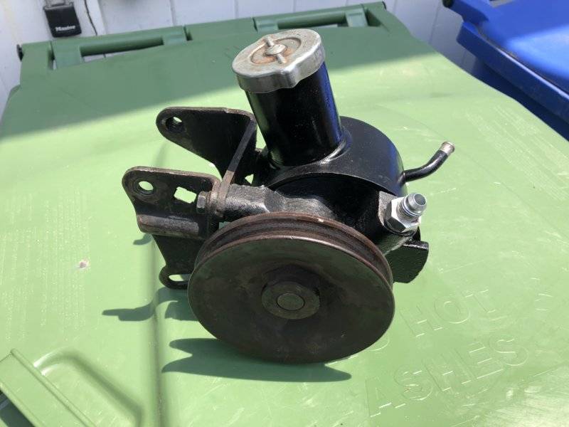

Got a tow home and removed the p/s pump and it does not appear that the pulley is spinning on the shaft. When I spin the pulley by hand I hear the pump moving/clicking.
I'm looking for opinions on next steps. I have no reason to believe there are any problems in the hydroboost unit, or blockages in the lines. I'd imagine if the pump was working and there was any blockage in the system I'd have a hose or fitting let go and fluid everywhere.
Does this point to a pump failure? If so, what are my best options? Get my current pump tested and rebuilt, or are there better pumps out there?
Thanks in advance!
No mention of pressure testing anything. An open line doesnt develop pressure.
Does the pump even pump fluid? If not could be as simple as a open bypass valve in the pump.
