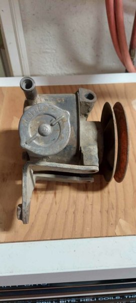

Hello,
Is this the correct pump for 66 charger 426 . I know the pulley is a little different for the Hemi. Is there any way to measure or id if the pulley is correct.
Hemi uses a federal pump
edit, Ive personally never seen an application where the hemi uses either the TRW or the Saginaw pump
Even though the TRW and Federal pump are very similar in appearance.
My car is running a Saginaw pump, but mine was converted from manual steering as well
Sorry for red X but that's the pump on my car. Missing front bracket but in @Stowe other thread posted what bracket he needs, 99% sure.
edit, Just did a quick ck and sure enough a TRW pump is correct for 1966,
My apologies I didn't know that
:lol:No need. @Stowe the return hose is a Gates the numbers on it 10RLA 5/8" 200 psi WP1 Braid Made in Mexico.
