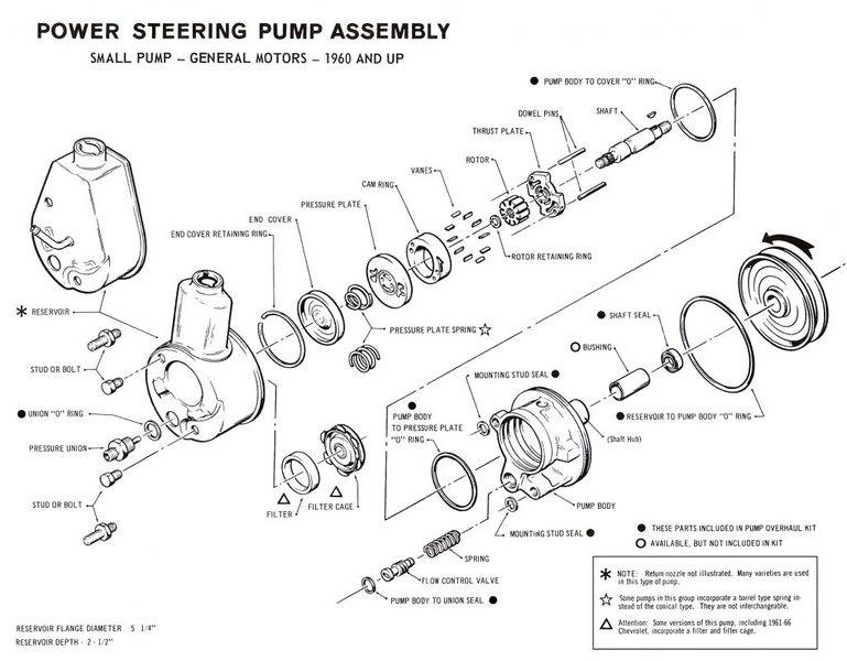

I have this style pump on a kmember in my back yard. Where is the pressure relief ball located. I can remove it from that PS pump if you need it. Its probably never going to get used. But it was a 318 Poly car so not absolutely sure its the same. I can check it out tomorrow. Crap the one I have may be a Federal.. I will check tomorrow.
The one I have looks like the pump in the center. Not the one to the left.

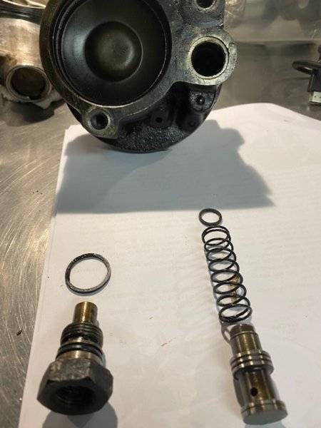

I've rebuilt allot of those pumps, not sure what "ball" your referring to.. They have a flow control/relief valve & spring behind the pressure line fitting but no ball...
Same pump different housing.

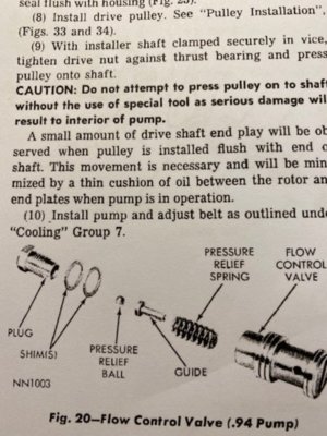

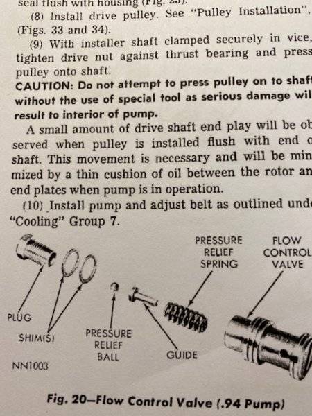

BeepBeepRR - see pic I got straight out of manual showing "pressure relief ball" I was talking about. Never actually saw it, I more heard it when the unit popped out. I have searched for it to no avail. I don't want you to go to any trouble but appreciate your response. The image you posted is slightly different than mine and it makes me wonder if I am hearing things. 1 Wild R/T post seems to think there isn't a ball at all. The concave in the tip of the of the flow control valve seems perfect to hold a ball - I have never done a steering pump rebuild.

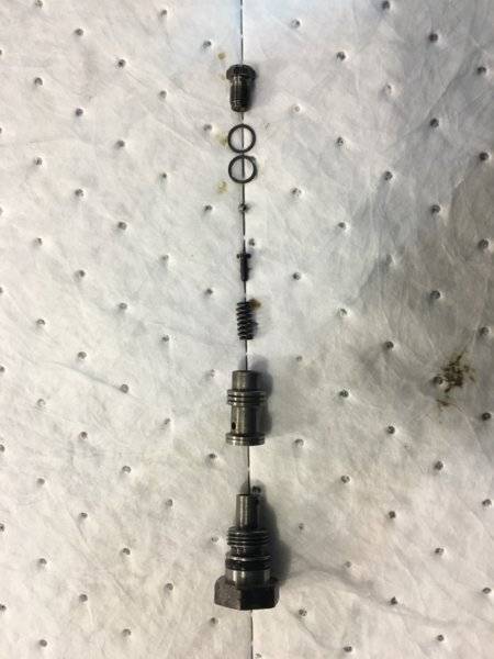

You can see it in my pic - this is the order it assembles in. Sorry, don’t know the size. That’s sounds like something I would do. This is the “Pump it down” modification from Ehrenberg and Mopar Action to reduce the amount of assist.
Do you want one or just the size of it? I may have one. BTW do you have a copy of that article, I've been looking for it.

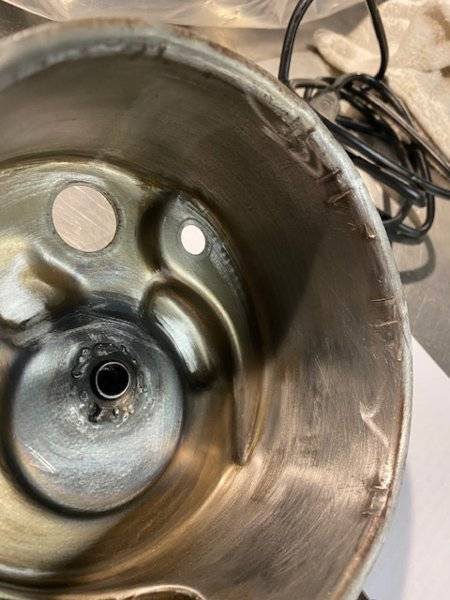

Stripped the paint off the housing (see pic), as you can see from the "hammered screw driver marks" that go all the way around it, I think this pump was messed with prior. I am missing parts. Funny thing is, it worked when I purchased the car 4-years ago.
