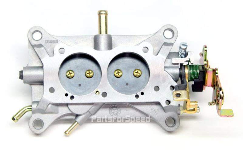

Does anyone know for sure which hole on top of a six pack center carb (#4375) is the one you drill out to install a Holley #125-500 "Power Valve Check Ball Kit"? I'm going to rebuild my carbs in the next week or two and I thought I might go ahead and do this upgrade while I'm at it. Thanks!
Thanks Silver..... I've got that diagram..... I'm just scared that I will drill the wrong hole on a six pack. Can anyone verify the hole to drill? And yes, I should have mentioned in my original post.... what hole on the base plate?
Here is a pic of one installed, I did my center carb a few years ago.

Thank You 440+6! I appreciate the confirmation.

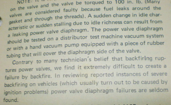

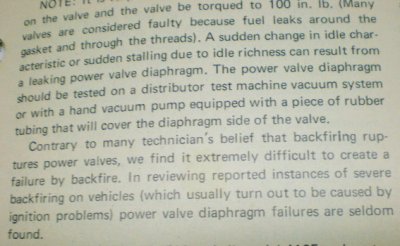

For what it's worth,direct from Holley.

Wow 62Max... interesting read. I've got a vacuum hand pump, so I might have to check one sometime. I think I will still put in that little brass restrictor for the power valve circuit just in case.
