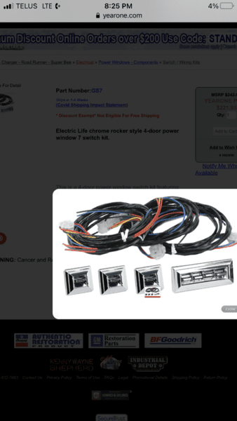

Hey Guys My 69 Satellite Came With Power Window and Some Of The Switches Are Broken.. The Price For New Switches Is $120 - $200. Not Too Keen On Using 50 Year Old Switches If I Don’t Have To.
Is It Possible To Use An Aftermarket Harness Such as An Electric Life One?
Or Does Anyone Refurbish These Harnesses?
I Purchased The Relay Kit From Member Crackedback
Repro switches are available now.
There is also a guy that rebuilds them.
Check ebay for both.
Those in the pic above are generic gm style.
IMO the correct switches look way better, esp if your car was a factory PW car.
