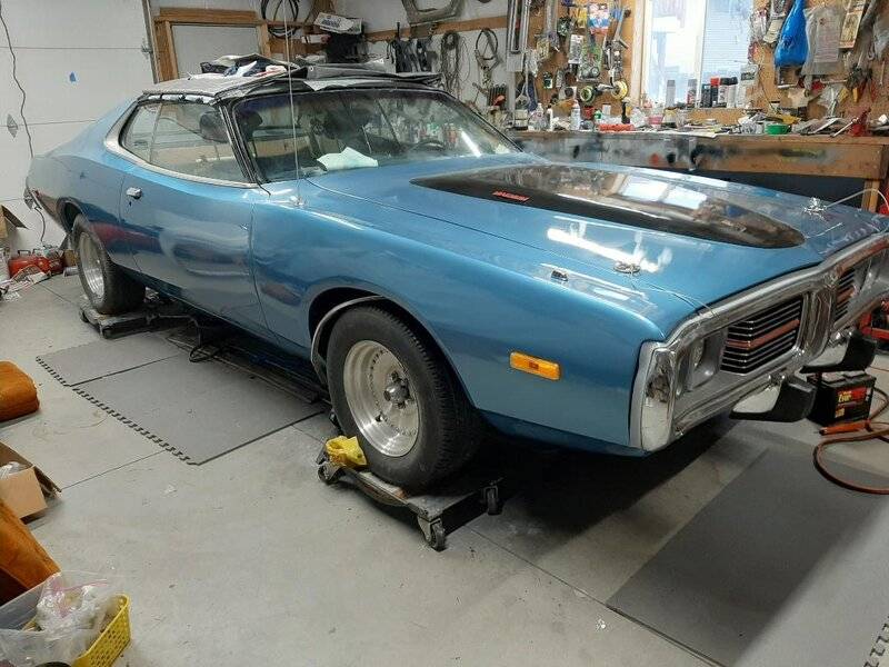

I used it on my 74 Charger since it is a car that will be driven by my grandson. It took 4 coats of color and 3 clear coats for good coverage. I had them mix 2 gallons of color at the same time. It was great for the trunk and engine bay. Just okay for rest of car. I got it for a very good price though. For a show car only, I would have gone the next line up on the paint.

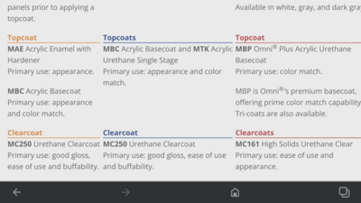

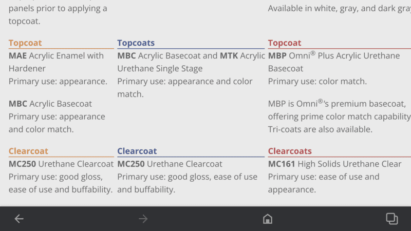

Looks like there are 3 lines of Omni one being acrylic enamel the other two acrylic Urethane. I was quoted for the midline urethane. But it looks like nobody thinks the Omni line is worth using. Looking at Deltron and Automotive Art. Not being in the business of experiencing using the different paints I am at a disadvantage in trying to figure what to use vs cost…..
