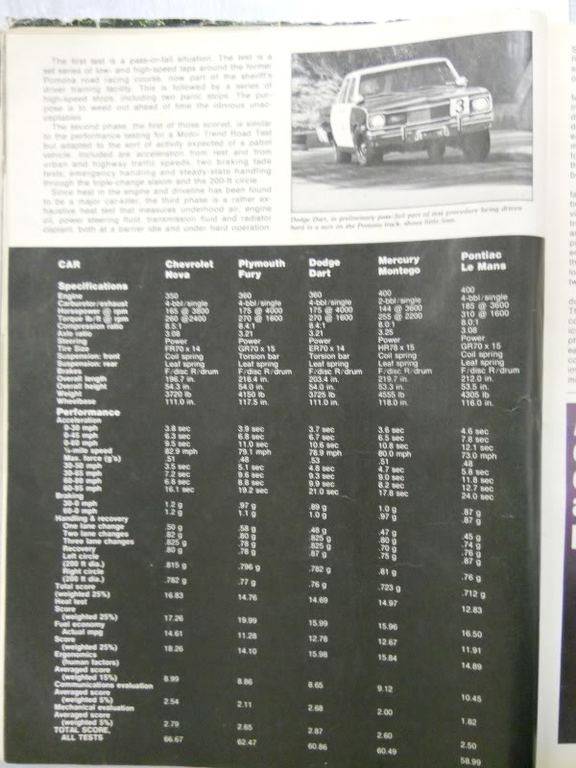

Cranky is correct about using a rear sway bar. It will really help balance the handling front to back.
And Mopar used them on their cop cars since 1968......
