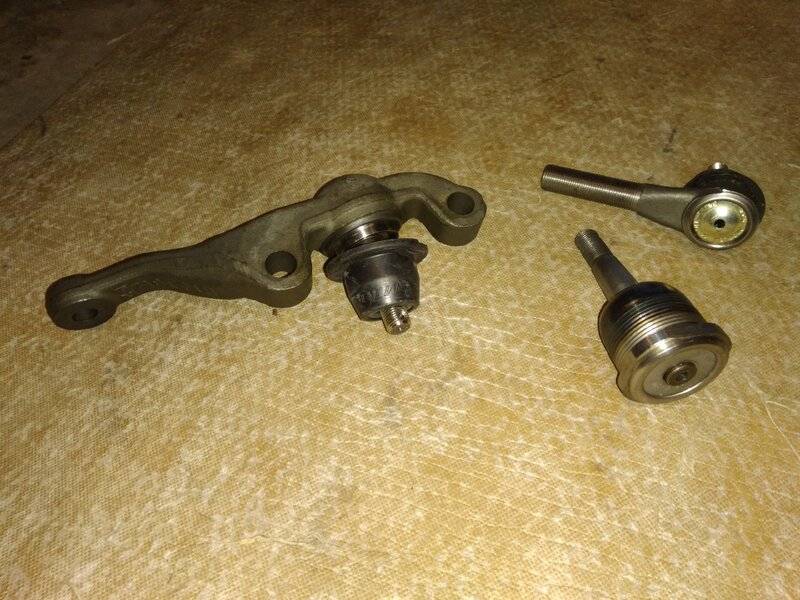

So, I'm wondering what you guys have had success with keeping these things looking new. Boeshield, RPM, clear coat? Also, a book I have says to media blast the upper control arm bushings before installing. What is the purpose of that? Thanks for any input!

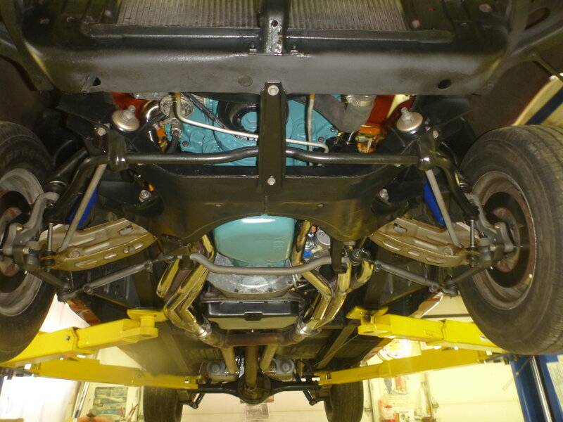

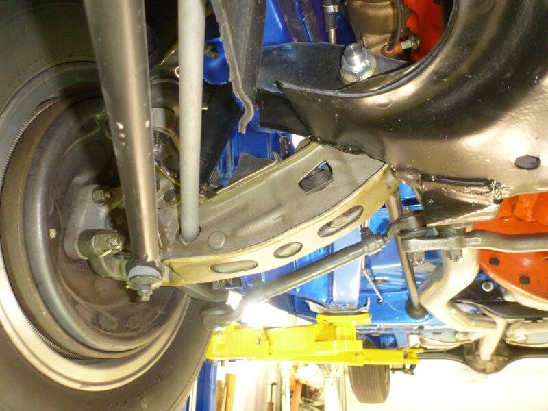

Did my Bee parts with RPM 4+ years ago now..

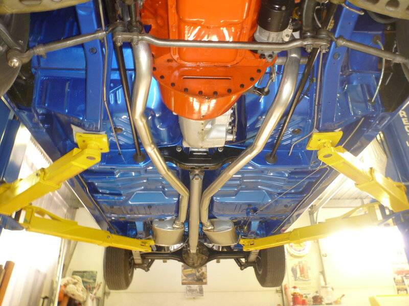

.. and the Dart with Boeshield T9 this Winter. We'll see who rusts first....

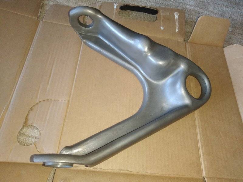

Here is a control arm that I used RPM on then a spray of Bowshield. No Ill effects and I think it looks great!
