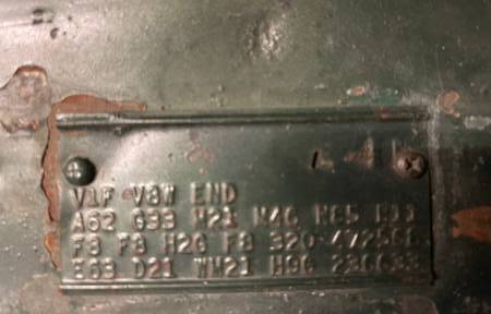

For posterity:
VIN: WM21H9G236633 ? Difficult for me to read the last six digits.
The condition of the fender tag is what I would expect to see:
Screw on left is painted.
Tag is creased near the left screw.
Screw on right is not painted.

Fender Tag is an original, no fake, so no worries from that point
