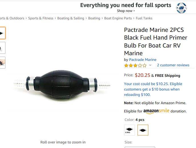

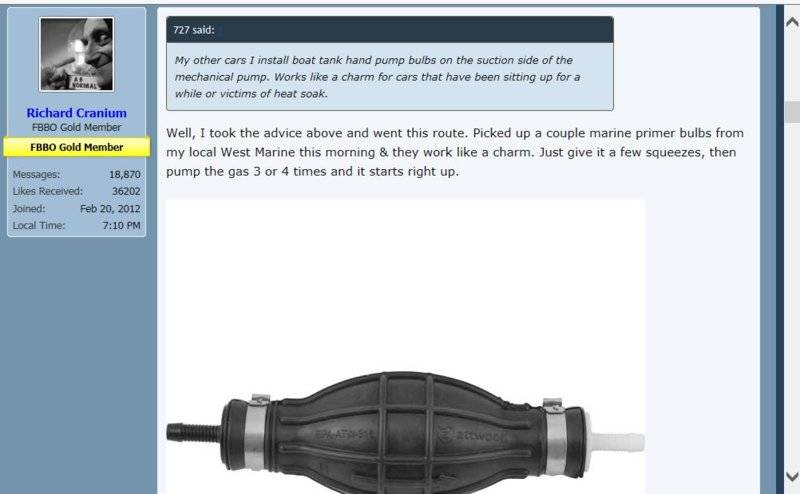

One these inline, buy one that matches your hose size. Someone in thread "crank crank ".
