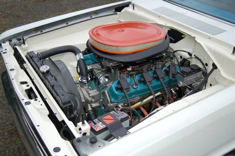

I highly recommend Holley EFI. I had one customer with Pro M stuff and eventually he trashed it and went Holley. I use a Holley Dominator MPFI system on my Duster and a Holley Sniper setup on my Coronet. All depends what you're trying to do and what the budget is.
