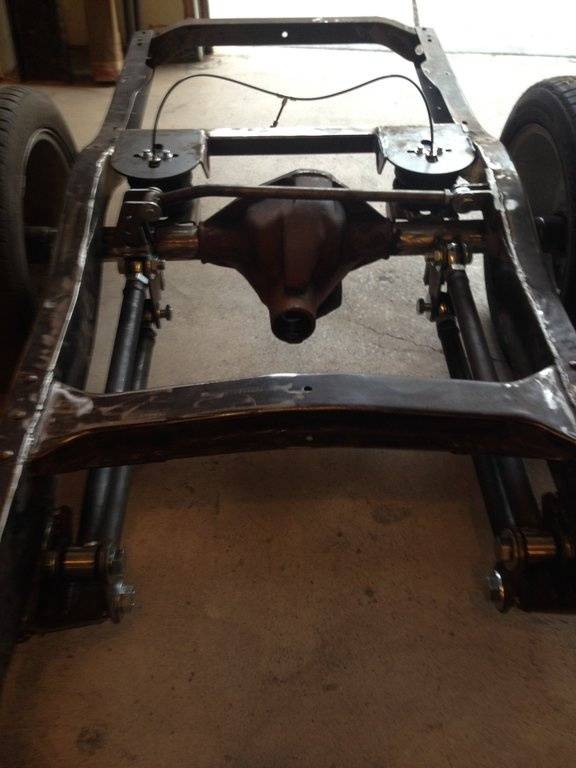

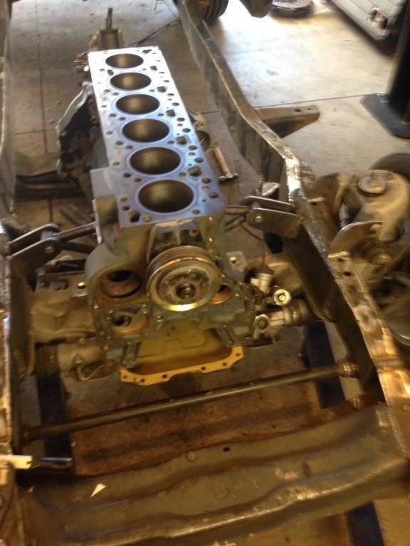

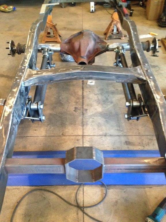

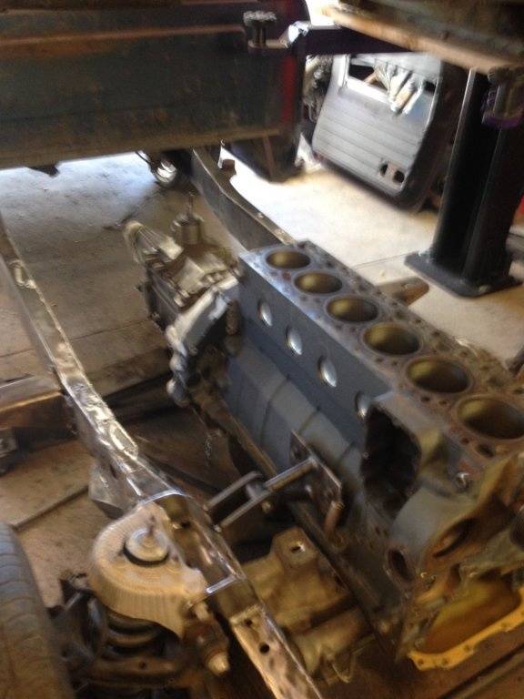

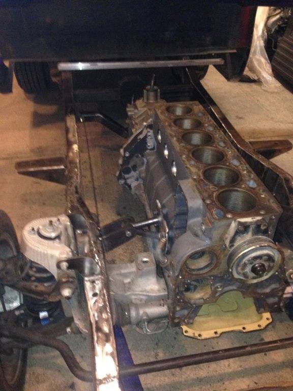

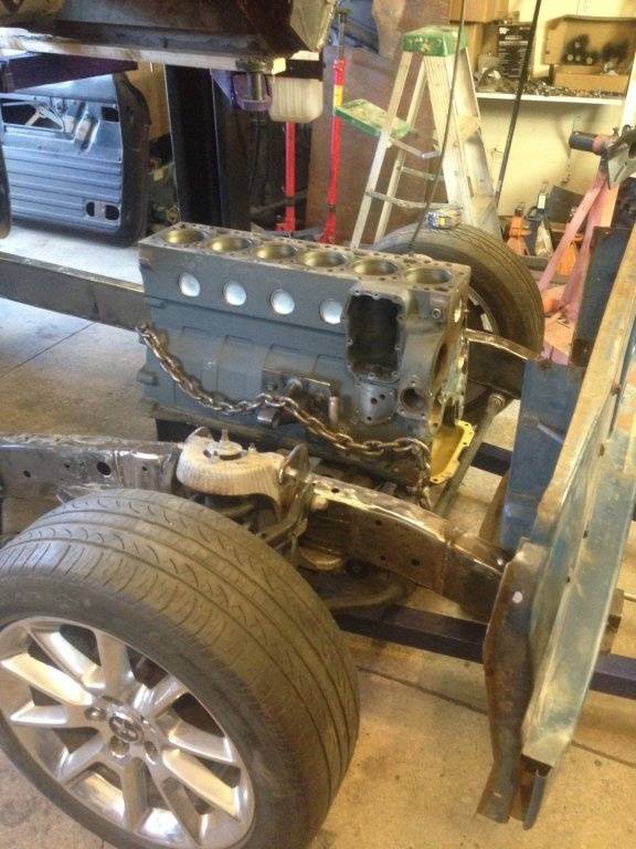

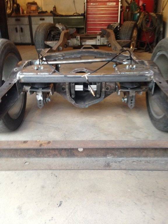

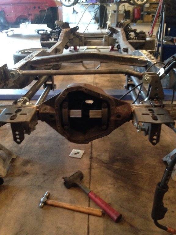

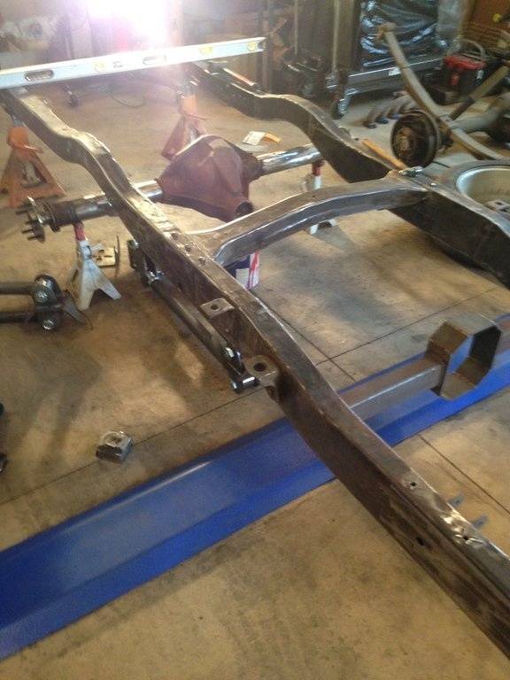

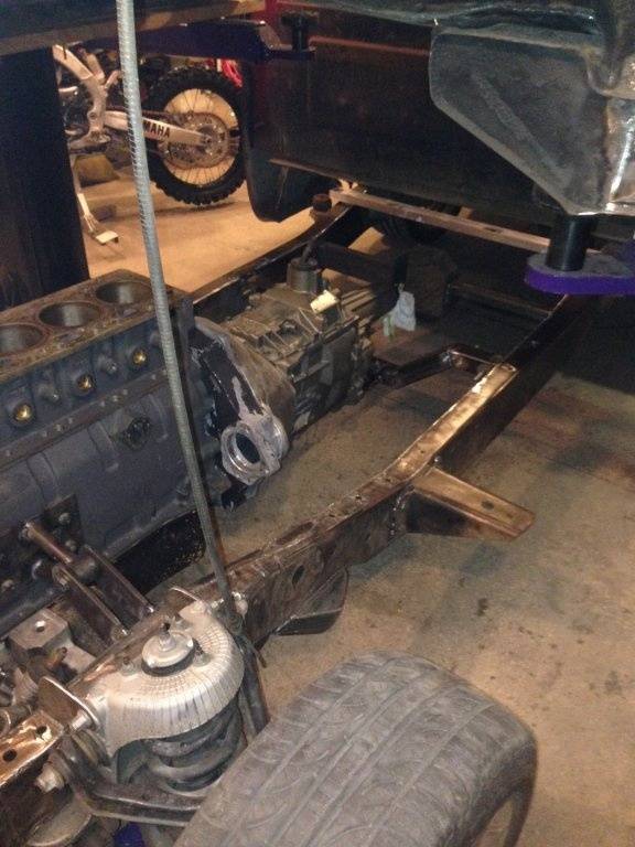

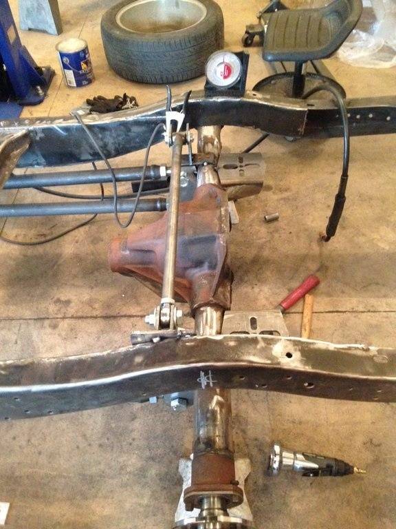

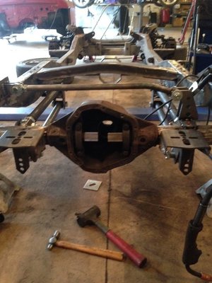

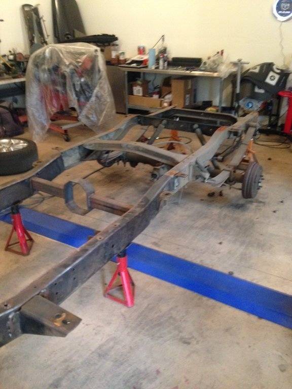

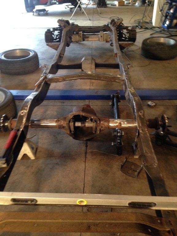

Good morning Mopar enthusiasts,I wanted to share my pro touring truck build.
I am building a 1966 Dodge D-100 Sweptline.

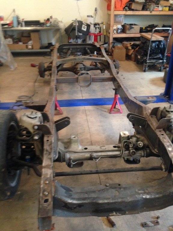

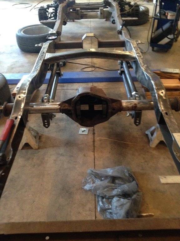

So far what I have done is replace the front leaf springs with a front clip from a Crown Victoria,in the process of boxing the frame and adding a four link suspension.
The pictures I have are not that great but as I start getting going again I will have better photos to share.I am in the process of finishing the Engine.

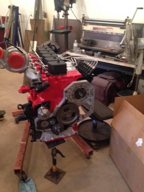

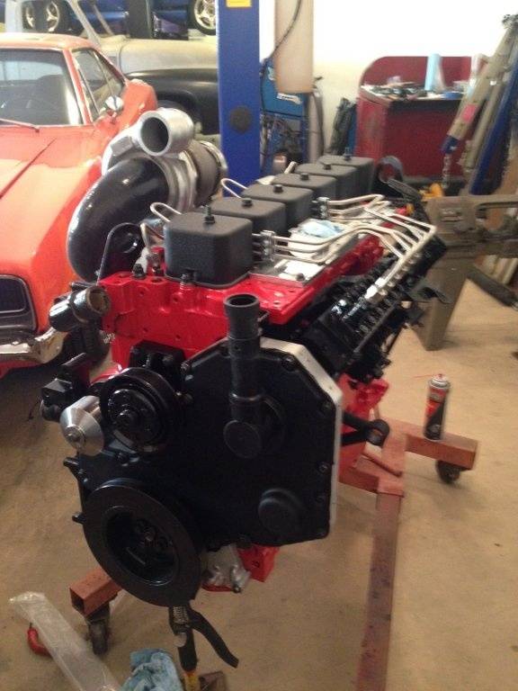

So the drive train is going to be a 6BT 12 valve Cummins Turbo diesel.1993 block,head and rotating assembly,913 P-7100 CPP hot street built injection pump,hamiltons cam,Diesel Power Source 62/75 Compound turbo kit.4L80E Four speed transmission.Dana 60 out of a 88 Dodge 3/4 ton that I cut down and put 8-3/4 housing ends on.I am hoping to do about 550 HP and around 950 lb/ft. of torque.

I like it. How hard was the front suspension swap?
Why didn't you use a later Dodge frame?
Why didn't you use the motor mount pad on the CV cross member?
I'm not criticizing, I want to do something similar in the future.
I would guess that using the ford-car stuff, made it a bunch easier to lower...and after-market parts are probably everywhere for really cool stuff.
The crown vic front suspension offers more aftermarket support than a newer Dodge truck frame. I am doing air ride and also want to get this truck low and to handle.Also using a later dodge frame I would have to start over with mounting the entire cab,fenders and bed. With the crown vic I just boxed it in and make the mounts.
The Cummins motor is wide and the mounts would be below the engine.With the Turbo Diesel the engine has so much torque it needs a mount that spreads horizontal.If you were to do the mounts vertical it would probably snap the mounts on shut down.
Honestly the way I have my mounts It might still do that.I won't know until I get it started.
Also the frame needs a little surgery to get the crown vic front end installed.
Sweptline frames taper in and down.

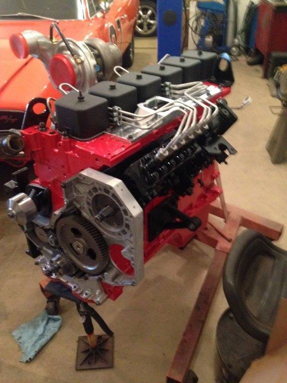

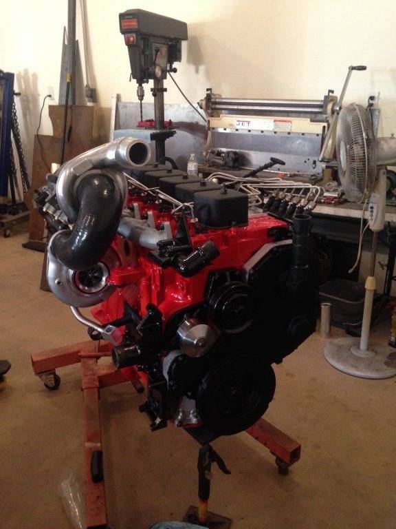

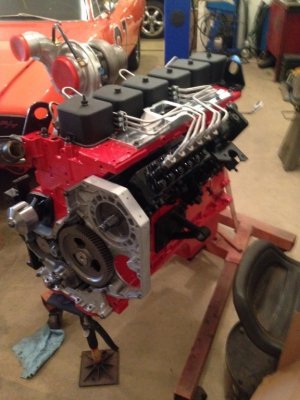

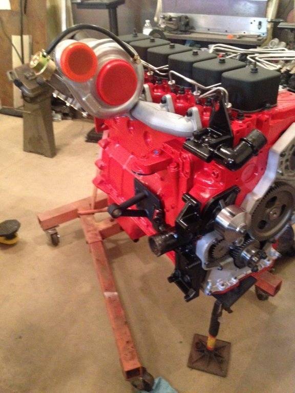

A couple more pics of the engine.I set the timing on the Injection pump and started building the compound turbo setup.

Did you use someones link kit or make your own?
