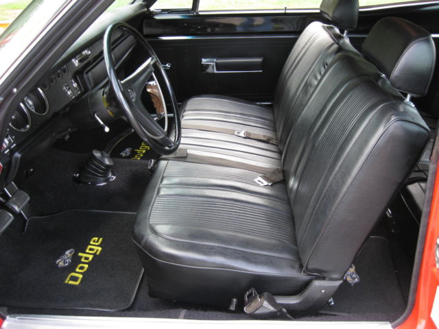

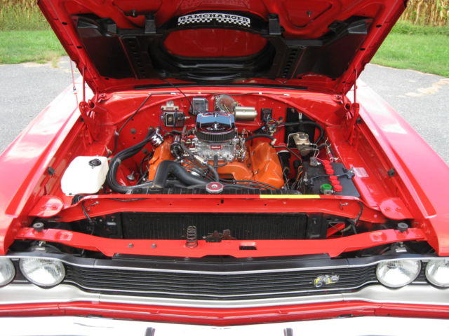

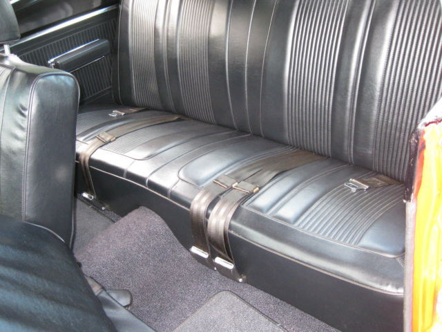

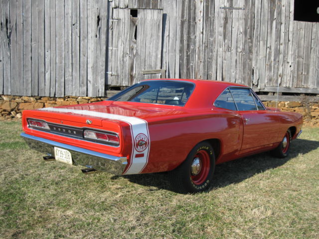

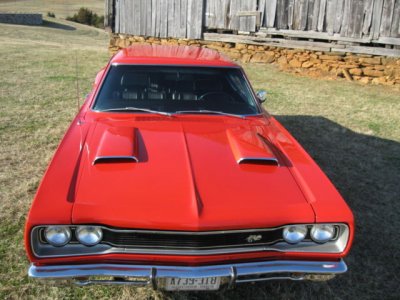

We would like more pictures of your cool car too.
Ask and you shall receive! lol
440 Dual Quads -- A833 4speed
Looks as it did the day it rolled into the showroom (with a different shifter handle)
Also, a little bulkier under the hood!
