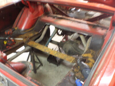

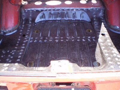

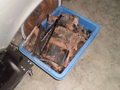

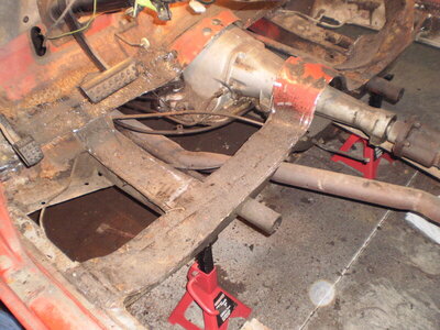

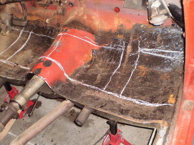

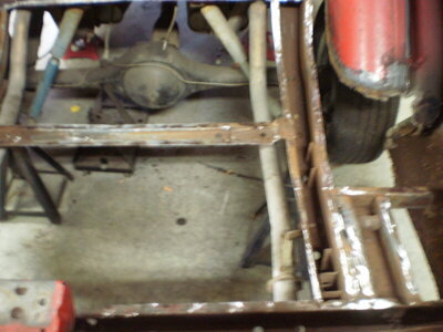

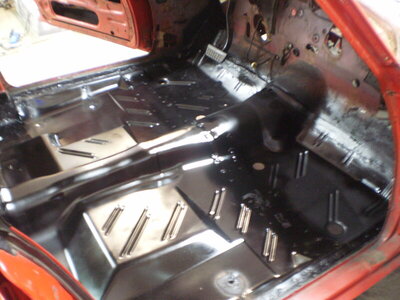

Here are some destruction/construction pictures of my 1964 Polara front and trunk floors replacement. That is my original floor in the blue bin. Maybe I should list it on Craigslist; " Original 1964 Dodge front floor for sale. Best offer " LOL

Holy Sheep dip Batman. That is way way beyond what I am looking forward too. How long did it take you to get the floor back together?

It only took my friend about a day to weld new floor in, but I had spent about another day laying out weld lines and drilling weld holes in the new pan. What took the most time was getting the old floor out in sections with cut off wheels and chisel.
