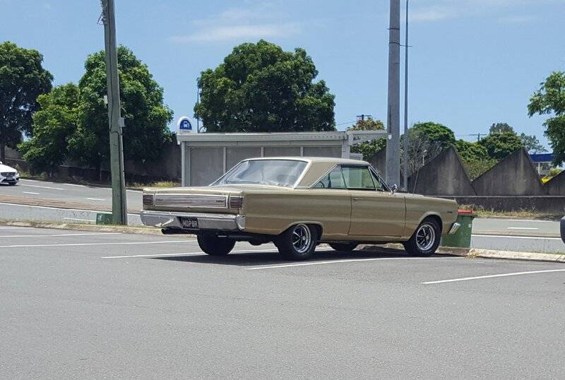

Mine's been on the road for 3 years now but I'm still working on it (refreshing the interior at the moment). I had my hood repainted a few years back as a standalone job (to fix some screwholes from the scoops being in the wrong place). I can't stand it being off the road for more than a week or two at a time. I just want to drive it as much as possible.
