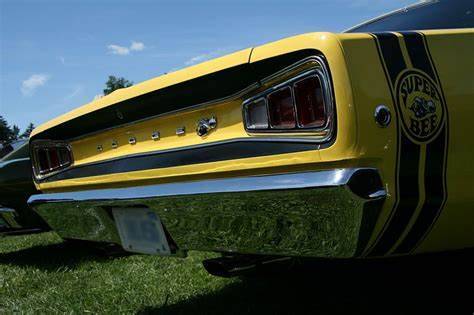

I have been restoring a 68 Super Bee and have been trying to get accurate information on original appearance of the car. Obviously, there is the main stripe around the back. However, I have seen some Super Bees with two horizontal black stripes on the top and bottom of the tail panel and some without. Was every Super Bee given these stripes, was it an option of the buyer, or did it only come with cars that had black instead of white stripes? Thanks for any info
Most people get the tail panel treatment wrong; the bumblebee stripe is indeed
two thick stripes in the middle, surrounded by one thinner one on each side.
Here's what things should look like:
The only problem with this picture is that in 1968 - there was no metal Bee emblem.
There was a decal Bee on the tail panel where this one has the metal one.
Grille had the D O D G E letters only, no Bee or anything else.
I remember seeing a few on the dealer's lot(new) with stripe delete. Just the circle & Bee; most were like Ed showed. On mine, the rearward edge of thin stripe was 3/4" from edge of chrome marker bezel.

Brain pan not engaged correctly, think you're right. I "think" they all came with that. And, not in white(?).

Flat black for every one I've ever owned or have seen original examples of. YMMV
