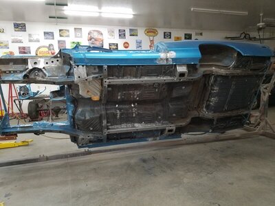

Here is the point I am at with my 69 RR. Metalwork should be about done and will be getting it sand blasted in a month or so. I have always epoxy primed, base, and cleared the bottoms. And then sprayed Resto Rick's undercoating in the wheel wells. The guy painting the exterior stopped over today and said he has sprayed tintable Raptor upol underneath the last 2 cars he did.
What are you guys thoughts one way or the other? Not a show car and will be driven.
Curious as to where a guy would cut off the bedliner at the front? Really wouldn't want to see any when you open up the hood, but the bottom and outsides of the front rails along with the front wheel wells should be covered, I would think.
Anybody got any pics of how they did it?

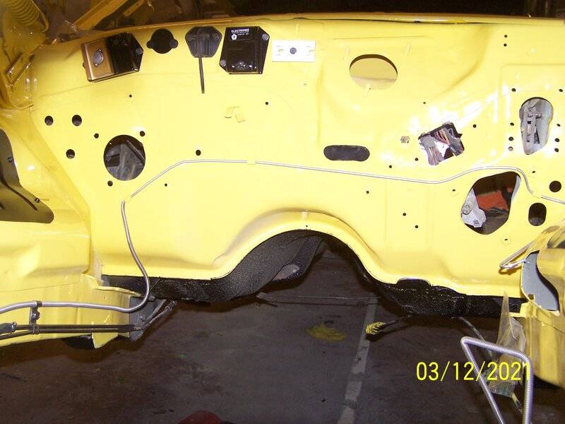

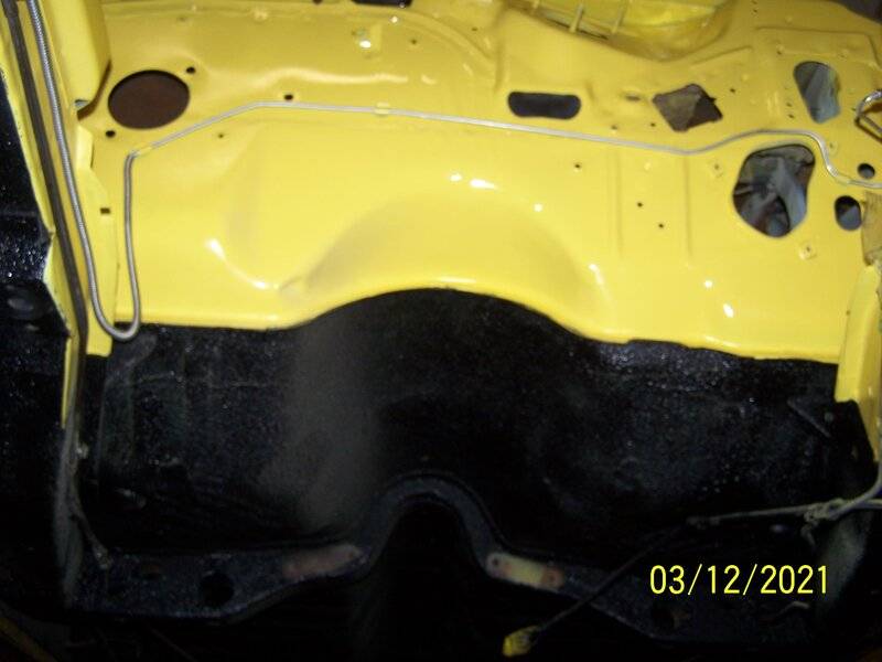

While not being 100% factory correct, my GTX had Wurth Body Schutz sprayed underneath from inside the sill right across, and from the rear panel forward to the seam between the floor-pan and rear of engine.
The Body Schutz was then sprayed with several coats of Mat Clear to make underbody clean-up a lot easier.

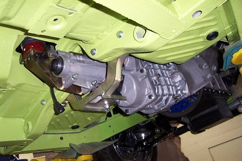

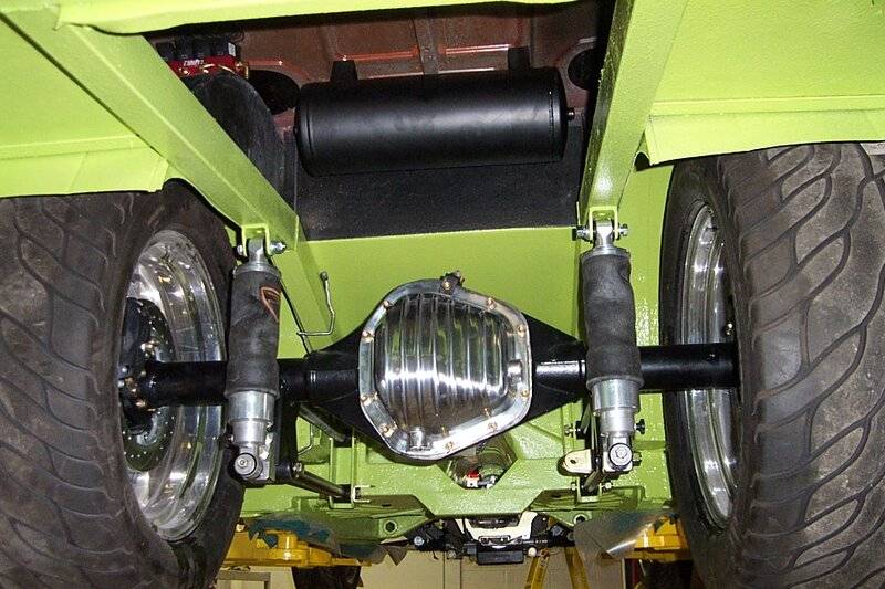

Years ago we built a Cuda and had the underside done in Sub-Lime bed liner. It is very durable and permanent. Gave the metal a real solid sound.
I don't know if I would recommend it though. Kind of a personal preference.

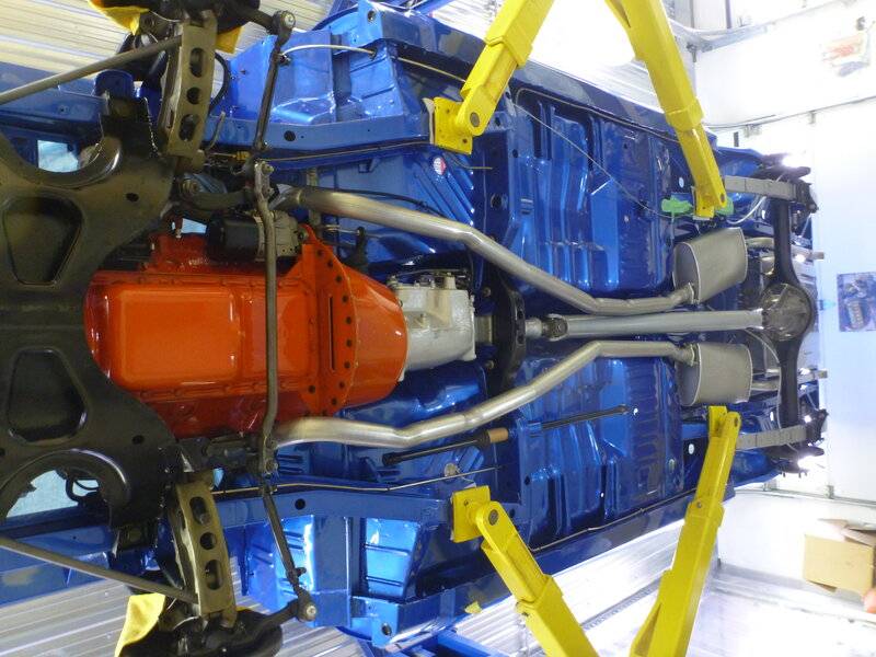

Kern Dog
Life is full of turns. Build your car to handle.
12:21 AM
Apr 13, 2012
30,410
99,758
Granite Bay CA
How does this car NOT fall off? Are those yellow arms magnetic?

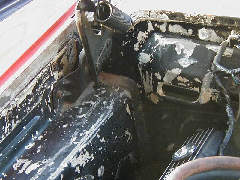

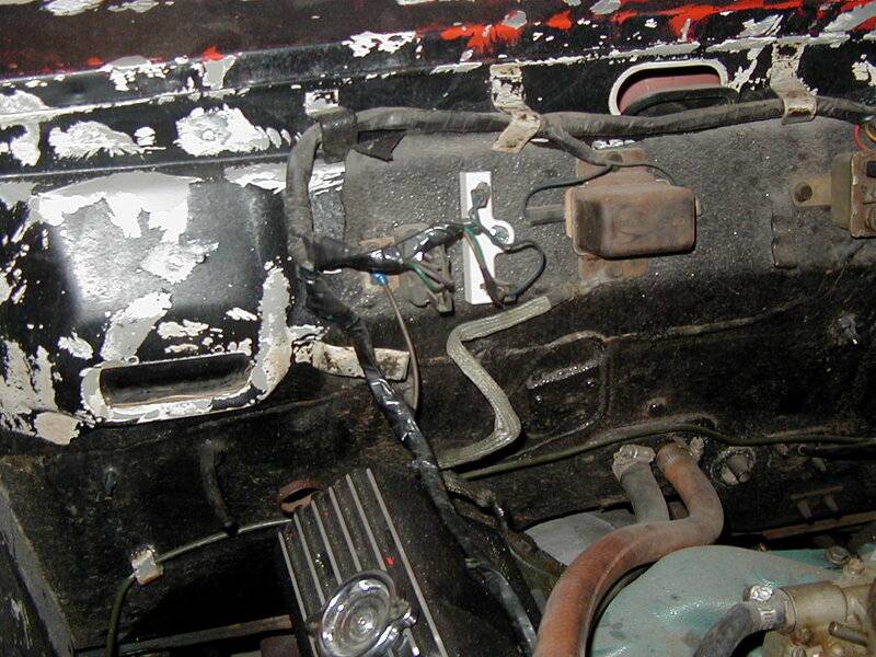

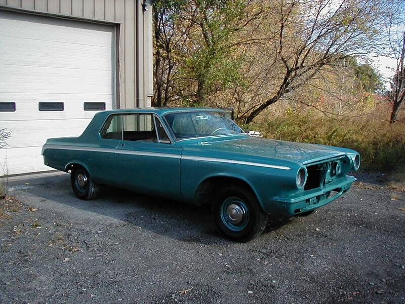

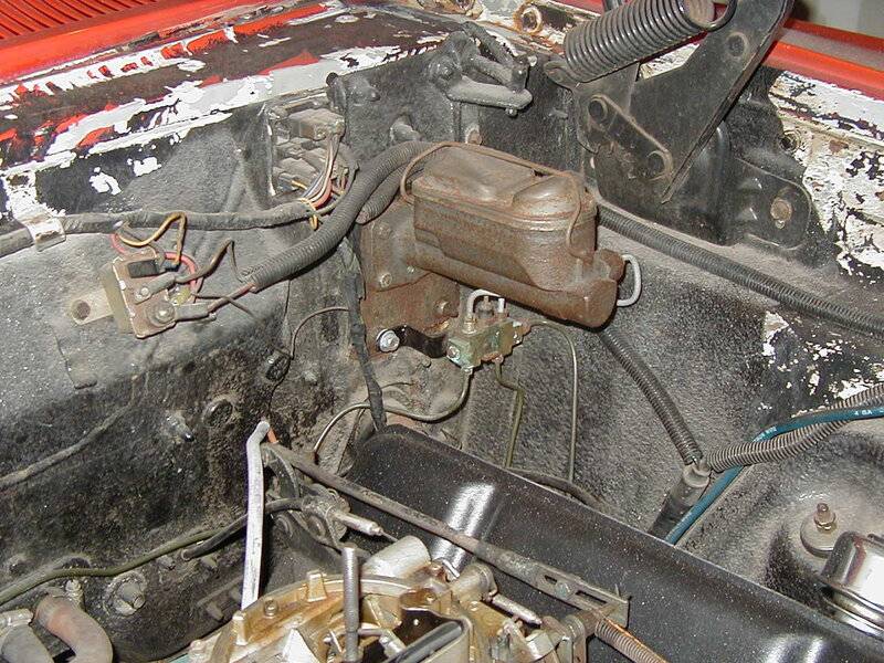

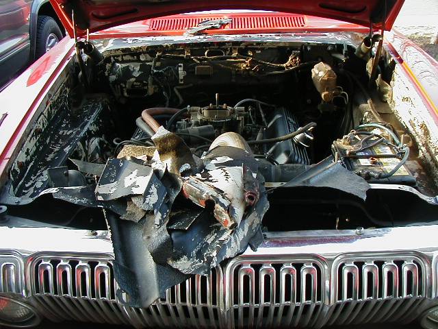

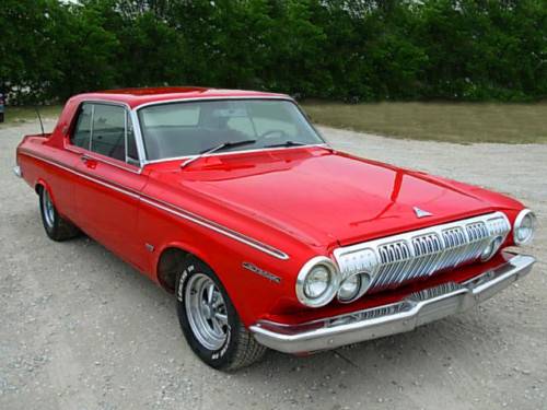

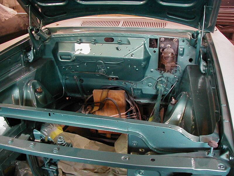

I realize this is the extreme but.....it does come off. This was on a 1963 Dodge 440 that I bought, this car came out of Texas.....
P1010012.JPG Engine compartment.JPG P1010009.JPG Master cylinder.JPG !CDUPEvQBWk~$(KGrHqV,!ikE0HVF-!8BBNOI)Ce55!~~_12.jpg Painted engine compartment.JPG Engine installed.JPG Done right front.JPG
