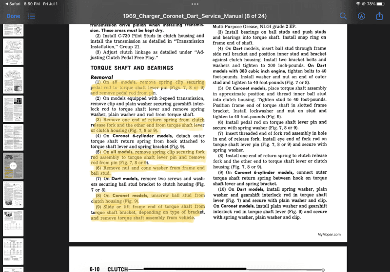

That may work but here’s the procedure in the service manual

Thanks, Beekeeper. That sounds easy enough. The shop manual should have been as clear.

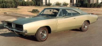

Thanks for the kind words, Nxcoupe. It was a family car and daily driver for many years. The photo I posted was of the day I brought it home from the dealer, 5 February 1969.

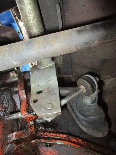

Next question, before I break something: How do I remove that spring clip to separate the joints? Access to the thing to figure it out is almost nil.
Them are kinda hard to remove but I use a small chisel and hammer to tap them off or a small pair of channel locks to push them off. I probably don’t know the simple trick to remove them:lol:
Looks like I came to the right place!
I got the spring clips off, but not sure exactly how. Suddenly - "POP" and it was lying on the ground. I had to struggle a little more with the second one. Anyway, the torque shaft is now out.

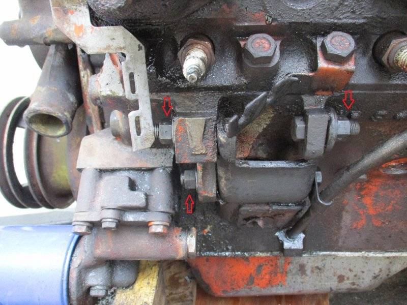

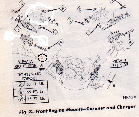

As far as I can tell, the only thing still attaching the engine to the car is the front engine mounts. If I pull the left and right bolts marked "3" in the photo, should the engine come out? Is there a better way?
Yes the bolts marked 3 will do the trick
Ditto, yep
I hope you have removed the hood, radiator and cooling fan. Sorry but I did not go back and read everything again.
Thanks to all for the confirmation on the bolts to remove. Yes, the hood and everything else in the way had already been removed. I pulled the left and right bolts but the engine did not come right out. After the hoist ripped the driver's side rubber away from its metal backing, and quite a bit of prying and shoving with a crowbar, the right side mount decided to release. The engine came out after that with no further damage.
I don't expect to have to do that job ever again, but it seems to me the easier way would be to remove the bolts from the top of the engine mount. Much easier to access, and no rubber to fight. Anything wrong with that approach?
That is a very hard way to do it, but it boils down to the fact you are doing the job and it's your car, so however you do it is up to you.
Well, thanks for your thoughts. Why do you think that is a very hard way to do it (I'm assuming you mean removing the three bolts shown by the arrows is a hard way to do it)?. What I thought was only two bolts and lifting it out turned out not to be so easy. It's obvious that many people on this forum have a lot more experience in removing 383 engines than I do (which was nil before this job), so I'm happy to listen to better ways to do it.
Installation and removal of the engine is done with the two bolts you first removed. Sometimes when removing you may need to lift the engine a small amount more one side this helps to get it free. I’m not sure why you had trouble removing it by removing the two bolts thats the best way and for sure the best when installing it.
