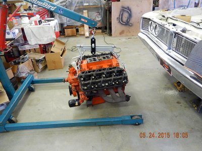

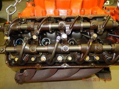

Got it out today, thanks for all your suggestions. Note the hardware store head bolts, whoever did it last didn't even use hardened washers. I'll get it into the stand tomorrow and start work. It also has what look like sleeves in the passenger side lifter bores, what's that all about? It also does not have a hemi-spec. torque converter, but it drives just fine.

I found the oil pressure problem- too much clearance in the lifter bores. Oil pours from the bores when I run the oil pump. It has about .008-.009" clearance- just about enough for oversize lifters if they're still available. I have a call into Ray Barton to see what they can do.
Just spoke with Ray Barton, he can fix it no problem. I'm in the process of disassembling the whole engine. It appears that the cylinders are coming in at .010 over, but there are no marks on the pistons. Time will tell what I have here. When this is done, it's going to be one nice hemi car.
