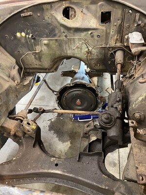

I tried that approach, I remove the headers and starter from the drivers side and used one of those:
I didn't have enough space to hit it properly, so I'm not very happy with the way the freeze plug looks in there.
on the passenger side, I had even less space.

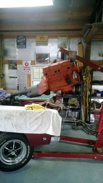

There is an easy way to pull the engine and trans as one unit and not damage anything.. I jack the rear end of the car up in the air pretty high which changes the angle you are pulling the engine and trans out. Everyone has their own way of doing it and without some of the better tools others have, ya gotta do what you gotta do. You don't really have to even use an engine leveler, just a friend to guide it out and maybe lift a tad on the tail shaft.
Precisely how I've done it last couple times (including the pic I posted earlier). Get the whole car up in the air, then do
the engine & trans pull together, friends helping.
