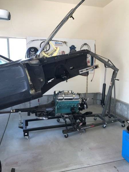

I do this by myself. engine/ trans bolted together, lift and roll the car out from under it instead of yanking on the hoist. lift, roll as necessary. I install them in the same way. super smooth and easy.
Who makes the engine/ transmission stand like in this picture? Thanks
I bought it from Year One back around 2006. The part number on the invoice is RC426
Glad I grabbed it, it’s been awesome to work with. I’m even contemplating firing up the engine while it’s on the dolly.
FYI this engine/trans dolly will be for sale when I'm done, along with the front and rear sub frame/dollies built for B bodies..
It's a 383 from 1968... I put in there in 1990 (Last time I did any engine pulling!)
Ok, thanks!
