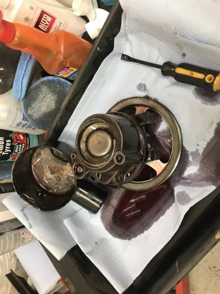

Ok I rebuild the pump and fit a new hoses....
Filled with steering fluid and started car and as soon as I went to steer there was a brief noise and no power steering. Topped up and steered left to right to bleed and nothing.
Pulled the pressure pipe at the box and the pump is pumping fluid. Pulled the return and my helper said there wasn’t much flow. There is no noise from pump or anything.
Any ideas? Is there anything in the valve body in the box that could have went wrong?

should have mentioned, I threw it on the lift and raised it when trying to bleed still no good. Steered both ways a dozen times and still no easier. Never had this before doing steering.
I meant to turn the pump manually but forgot. I have loved it up and it’s was turning fine and smoothly before I installed it. It’s pumping fluid fine.

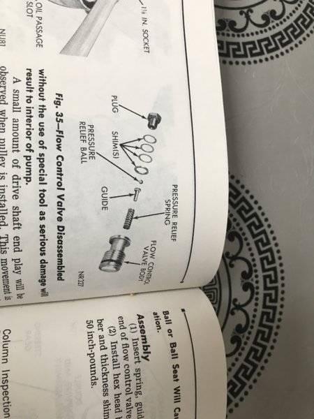

The only thing I couldn’t get at to replace was the pressure control valve in the pump. I took the circlip off the back but for the life of me couldn’t get the assembly out to replace to o-ring, but figured it would be ok since this wasn’t the cause of my leak and it was working before.

The manual says it should just pop out and can be checked /cleaned. I just couldn’t get it out. They seem to be set with shims and the manual states the correct number should be reused.

I just couldnt get the flow control valve end plug out. It came up but got stuck. I’ll pull it and recheck everything, might shave the aperture slightly to get the plug out.
The manual said that I should not depress more that 1/16” past the snap ring location on reassembly. It also states to press plug in and let the spring back up to try get it out. Can’t say for sure that I didn’t depress to far in my efforts to dislodge it it before I gave up.

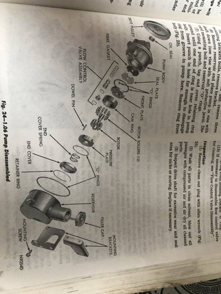

See images of my pump from manual

If the relieve valve is stuck you have to massage it out. Was this a good pump to start? How rusty inside? Here is how I have freed them and it can take from 1 to 5 days depending on how rusty/stuck and the condition of the bottom spring. I soak it in a break free oil, and tap lighty on the top of the valve to push it in some. This is light tapping to crack the initial position, then I tap on it like dribbling a basket ball. Letting it go down against the spring and pop back up from the spring. Soon or later you see it move up some. Once this starts it will come out. It is a machined fit. Be patient. IF the spring was broken underneath from rust. All bets off and chances are you won't get it out.
BUT, how did you put the pulley on? You did not press it on did you? Did you hit the front shaft and push it backwards? There are notes in the SM that warn you to be careful. If the pump assembly was knocked backwards against the large spring and cover, it has unseated and will not prime. Hope that helps, but I think you need to take it all apart again, you must have the relief valve move smoothly. And the former post is correct, you not suppose to swap valve and housing, they were a matched set.
Pump was weeping before, working fine. Used a tool for installation and removal of the pulley. The valve has plenty of spring there was no rust inside the pump housing.

Yup, drain and pull the pump again. You'll only need to pull the can off, to get to the valve, and check it out.
Can't make out the main shaft, that the pulley goes on...but, pretty much for any of them, when you press the pulley onto the shaft, the far end of the shaft MUST be supported. If not, it screws up the pump.
This is a federal and the shaft is threaded. So you can put the pulley on after pump assembled. The tool threads in to the shaft and pushes pulley on while pulling shaft out. If this was working, I would leave the relief valve alone. Getting it out that last quarter inch is because of the tight fit. If you push it down and it pops up against the lock ring it is fine.
Thanks it’s popping back agains the lock ring fine just couldn’t get it out. I have the tool to remove and install the pulley, but thinking back I installed the pulled before the reservoir, should have left it till last.
I may have pressons on the pulley and shaft when trying to get the reservoir on is what I’m thinking

Oh no!!! How was this not making noise?? Anyway have go through it all now and see if anything got damaged. Initial inspection it all looks ok.
The only thing I can think of is when I post on the pulley to put the reservoir on
