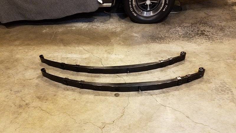

I purchased new leaf springs for my 73 Charger SE looks prett straight forward installing them any tips or tricks I need to know before tackling this beast ?
Look nice:thumbsup: where did you get them?
I normally will jack up the rear till there is no load on the rear shackles, disconnect them then lower the rear so the springs are clear of the rear bumper/valance. Remove one side and replace, then do the other. Jack it back up and connect the rear shackles with NEW bushings.
ESPO for the win! I posted in your other thread on the subject.
Super stock type springs have a slightly differnt arch left to right, could account for the difference.

Stock height or +1? Look forward to see how it sits with them.

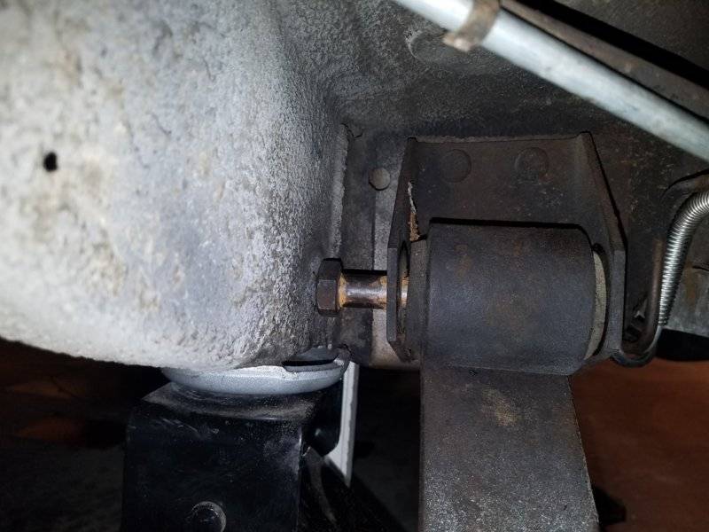

So I'm disassembling my leaf springs everything is going great then I run into this problem. The bolt is hitting the frame I can't pull the leaf spring out. Is my only option going to be to find a way to Houdini cut that that should be fun.
They are installed like that for a reason, Safety. You will need to remove the hanger from the frame and lower it to change out the spring.
I’m in the process of doing a refresh on my rear axle & leaf springs. You can remove the spring hanger from the body bracket-4 nuts to the rear. For safety, make sure the rear axle is supported if still in place.....Jim
