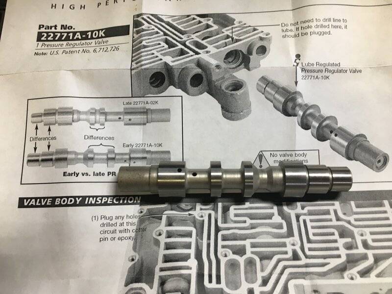

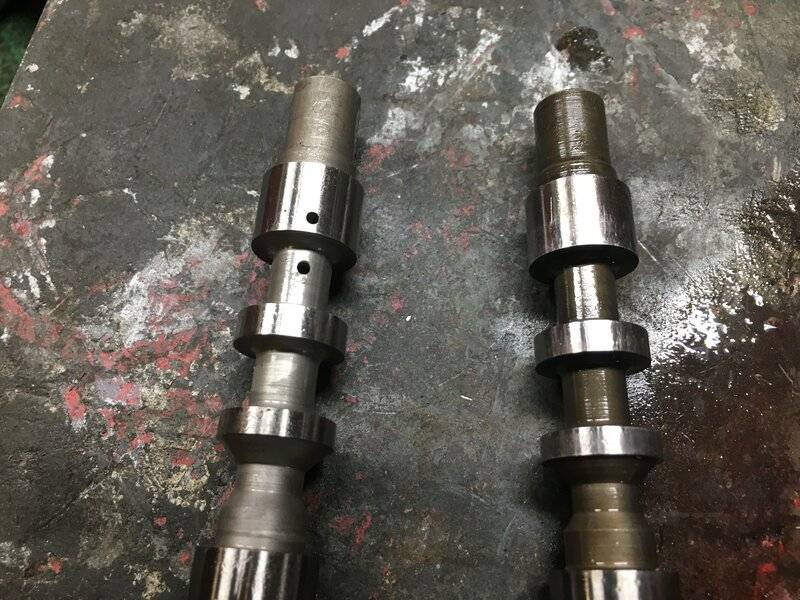

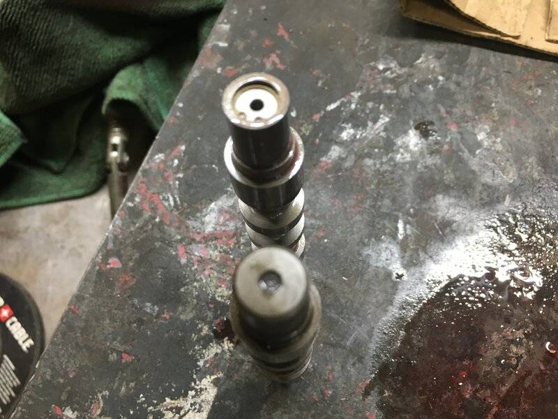

About a year or so ago I posted about a leak coming from the park cable housing. This was when I was helping a buddy out of state. Fast foward to today. The car is at my shop and I can play with this leak. In that year I did my research and found Sonnax has a Pressure control valve that helps with convertor drain back. When I pulled the pan today it dam near filled a 7qt pan. That was after leaking on the floor for a few weeks. Convertor drain back Yep. The new valve has a one way check valve for this and other issues. I will pull the park lock housing again as I have another one to compare and measure. Hope this keeps the pan level in spec, we shall see.
also shout out to 493 Mike for sending me parts for free. Also TransGo has a new manual valve in their TF2 shift kits for this.
