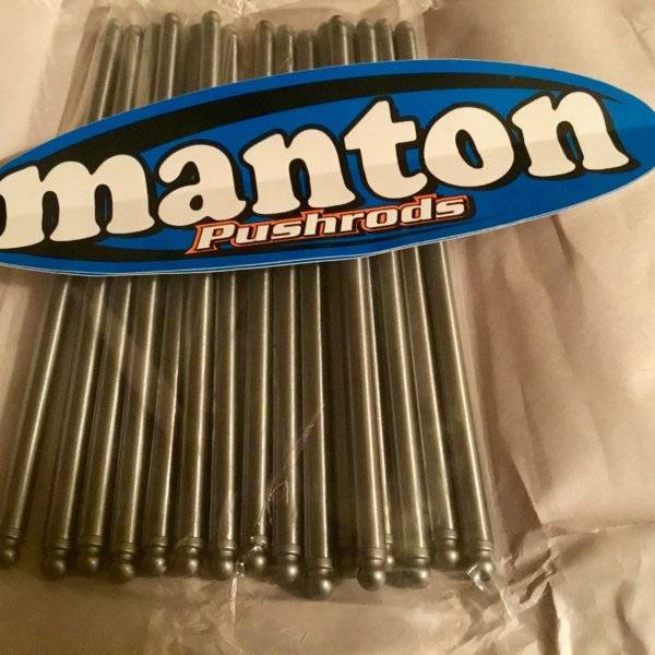

Street application. Rods seem to be the weak point. Went with these from Manton. Outstanding Customer Service. 2 day turn around.
