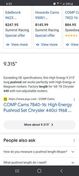

10 seconds on Google got me this. So you want a checker that will adjust to that. As 1 Wild R/T recommended, 9 to 9.5 adjustment. Took longer to type this than find it. If you were ever in the Army, you were probably doing a lot of push-ups for not researching and just asking.
Easier just to help instead of being a search Nazi thanks!!!!
