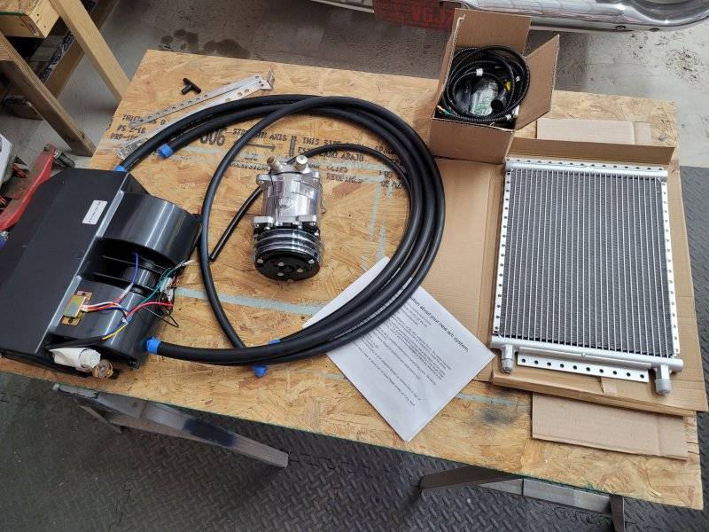

Unwrapping.... picture of everything included.

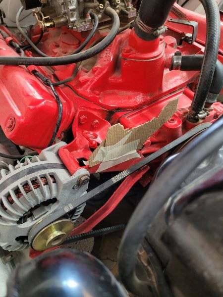

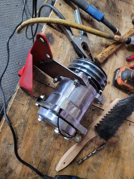

First thing I did was fabricate a bracket for the compressor. I welded up a piece on the top of the factory alternator bracket. There was plenty of room. On the back, I bent up and welded in a tab.
The compressor, when bolted on in front of the bracket, lines up the nearest pulley with the crank and alternator.
I need to get a 2 groove crank pulley and idler Pulley to do it right. I have a web in the marketplace if anyone has anything.

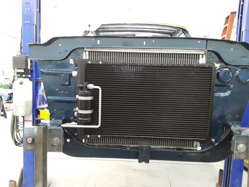

I have the condenser set where I want it. It needs a bracket welded up on the passenger side.

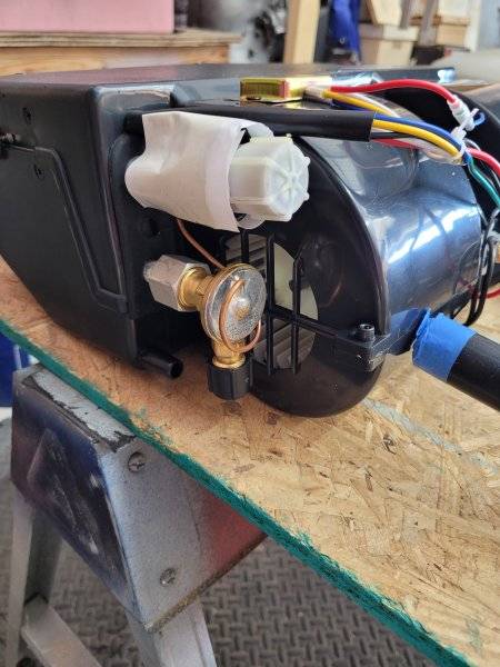

The only option I have would be off of the evaporator. I only have two low side fittings, one on the evaporator and one on the compressor. A long hardline would be nice to put it near the firewall.
I'd put it near the evaporator.. GM, Ford & Mopar all put the low side port on the Accumulator on CCOT systems...
If I put it on the evaporator it will be in the passenger compartment footwell. It's a single, rubber hose with a fitting on either end.
I would probably consider adding an extra connection... Run a short hose from the evaporator long enough to exit the firewall then have a connection which would make it easier to get the evaporator fitting tight before installing the evaporator & give you a service port location in the engine compartment but away from the compressor...
One of each, put the top one on the short hose since it's easier to pass through the firewall grommet..
Late start. I realized my liquid line would not be long enough if I kept the condenser fittings on the driver side. So out came the radiator to figure it out. To complicate matters, I also have a trans cooler in the way. So out comes the trans cooler.
Got the condenser re-mounted and few lines ran. Also mounted the drier on the pass side fender well. It's hot out so I'm taking a break.

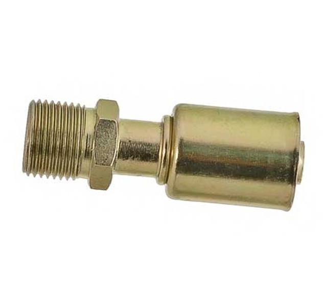

Tomorrow I hope to get the wiring done and inside buttoned up. I'm waiting on a beadlock fitting for the low side to move the service port away from the compressor.

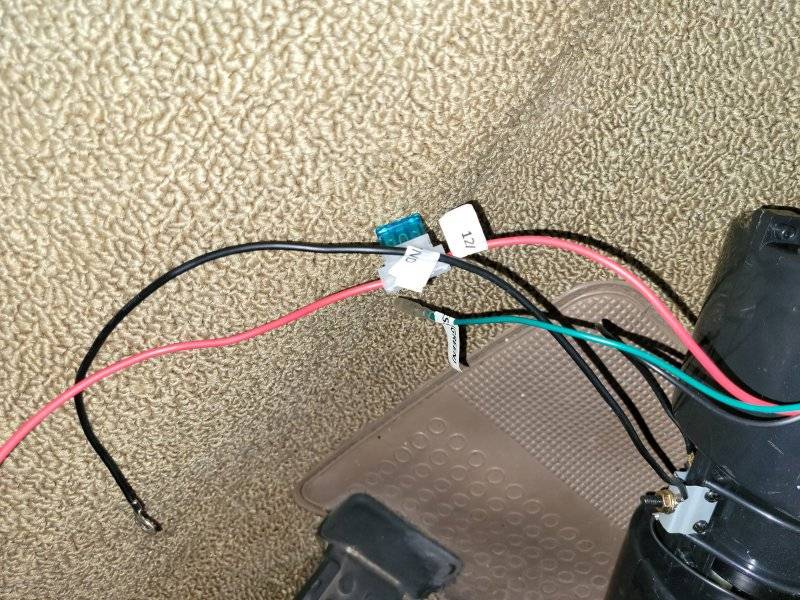

Updates: Inside is complete. There are 3 wires to connect. Switched power, ground and evaporator.
I pulled the fuse panel and there just happened to be a slot for a/c. The system has a 12a inline fuse, so I added a solid brass tube to the fuse panel. Crimped on a connector and it looks like the other fuse connections.
Ground to the dashboard.
