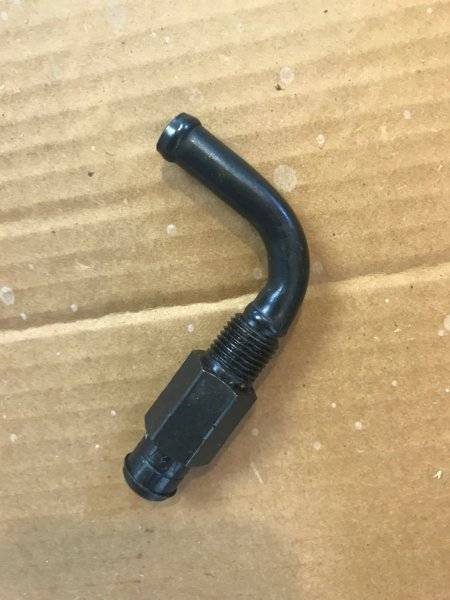

      PM me if you still want a NOS pvc. Retained by a nut from the top of the filler cap. $10+ postage.

      If your PVC valve is the original all metal type (should be), those things are rock solid, as far as lasting. Just needs a good cleaning, now and then. Only thing I know of that can make them bad, is rust. Shake it, should hear the valve floating freely.
      Yep, needs the correct hose, to work right.

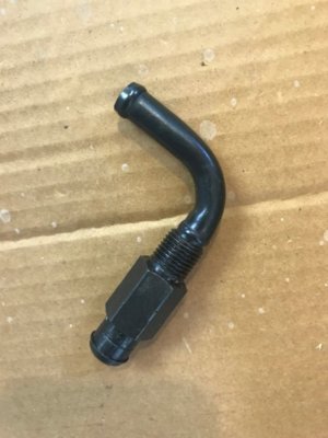

      Does it look like this?
