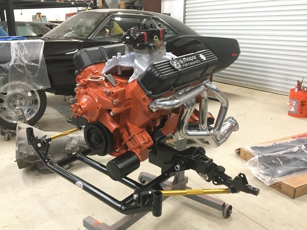

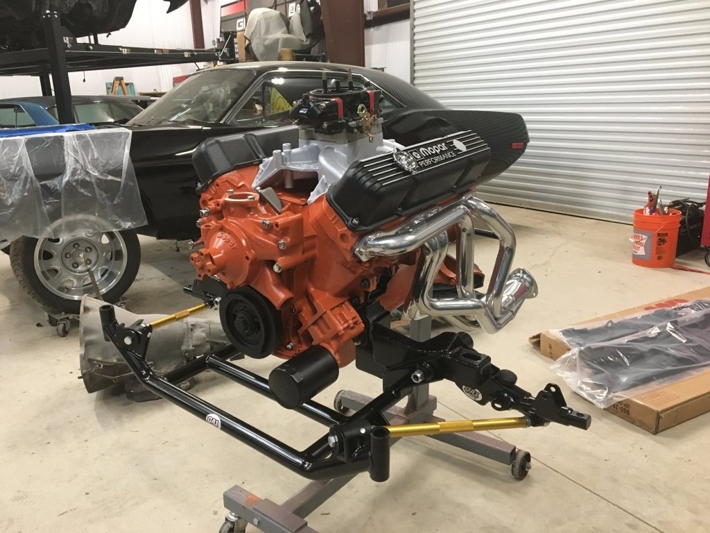

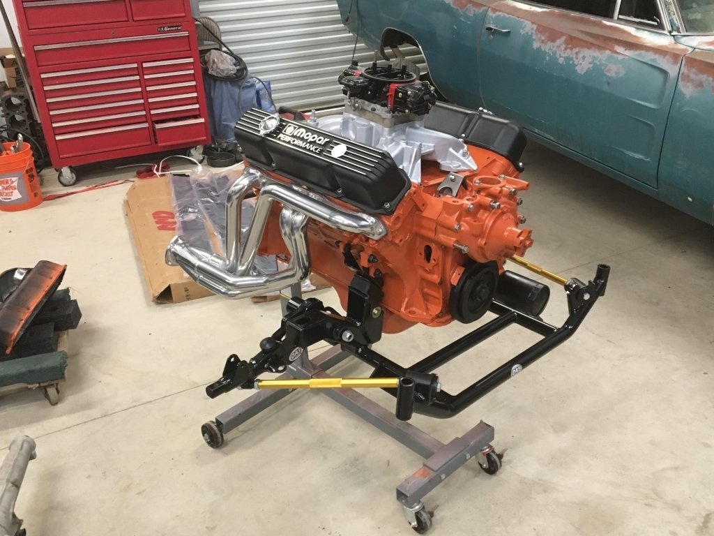

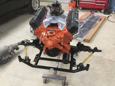

Got them in my `cuda. Nice...no steering stops.

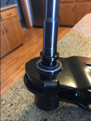

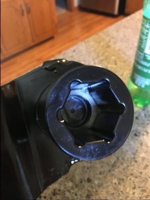

Got the lca's today, look great high quality piece. But it almost looks like the pivot shafts aren't pressed in all the way looking from the front side, but if you can look from the back you can see it's sitting on the lip? Thoughts...
