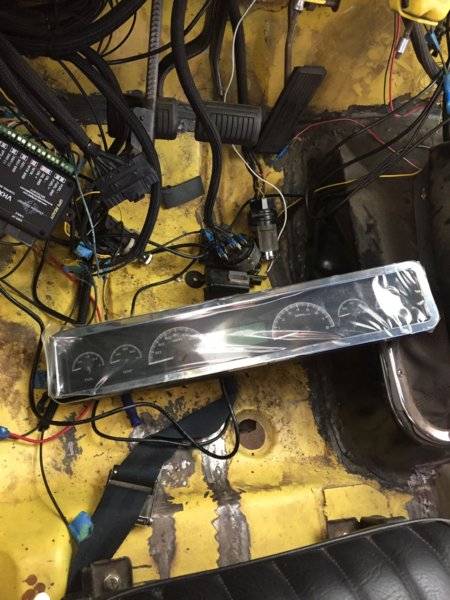

Just installed my rear QA1 TS901 single adjustable shocks. I’m looking forward to testing as soon as I get my dash put back together.

I will, gotta get the dash put back together and then I’ll hit the street.
did you upgrade the dash lets see some pics please.
Still in the process....
