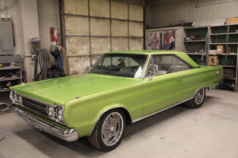

So, due to an accident of not-my-own-making, I've had to find new driver-side quarter window glass for my 67 Satellite 2dr hardtop. I first tried AMD, but their glass has the wrong front-to-back curvature and will only work as a hole-filler, not as a working window. I've now ordered a window from Auto City Classic. I hope that works...but my spirits are pretty low on the chances.

The car in question.

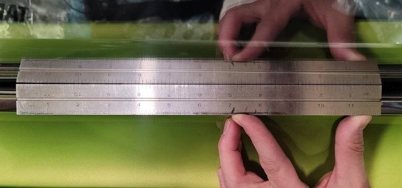

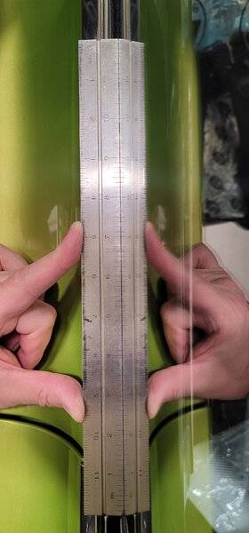

The Auto City Classic glass is about as curved in about the same places as the AMD glass, so I'll be sending that back. Here are some pictures that I sent to AMD to show the difference in curvature. These are from the front edge of the window with AMD on the left.

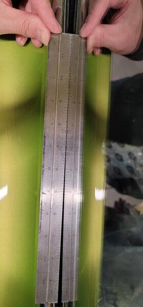

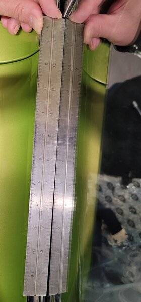

These are from 6" back from the front of the window with AMD on the left again:
