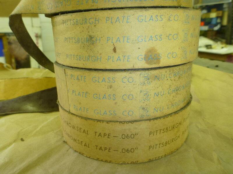

What are you using or do you guys recommend for the thin strip of rubber that holds the quarter glass in the bottom and the front chrome strip?
Ben

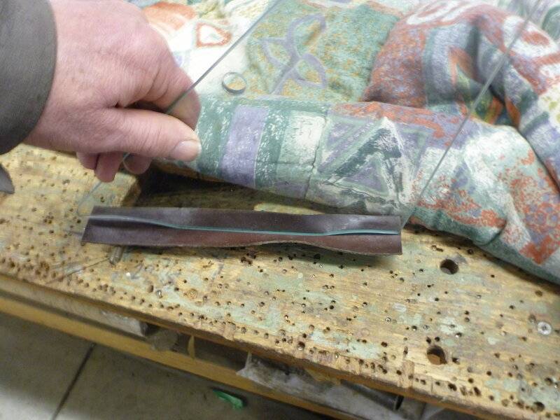

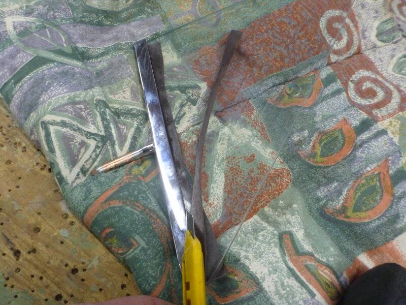

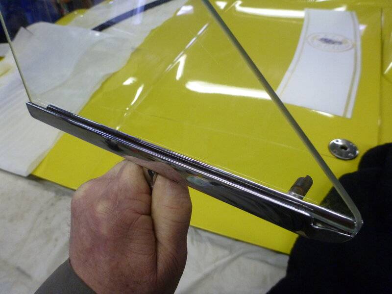

Glass setting tape.. I used .025 on the stainless trailing edge of my Bird glass and it worked as well as setting the vent windows on the Bee. Any glass shop should have it.. .025 or .032 will work.
