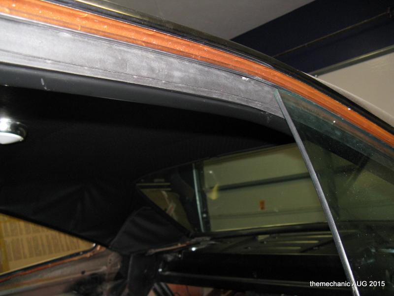

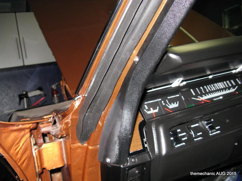

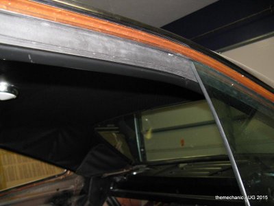

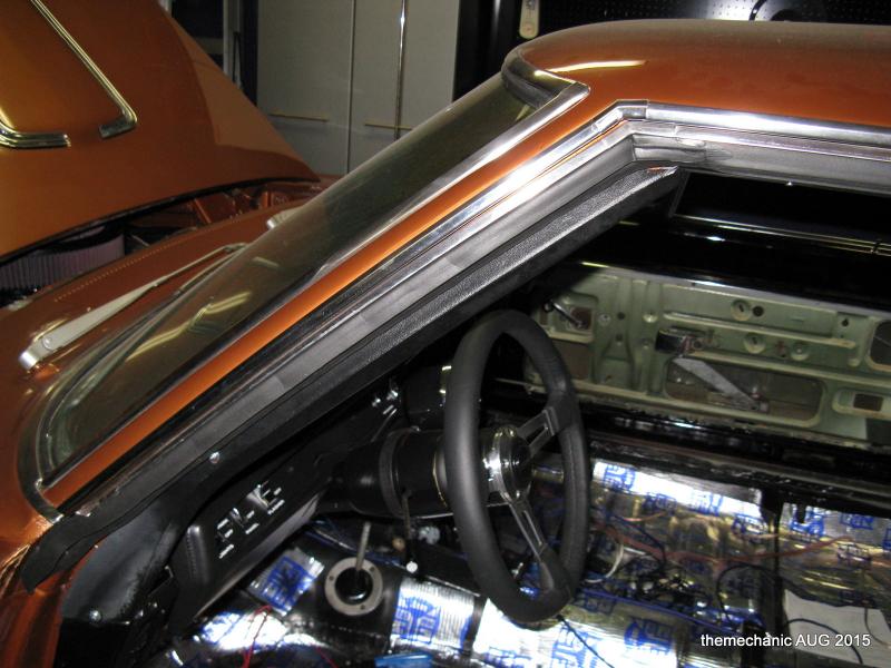

I just read your thread about this from 2012. Would you look at my roof rail seal photos and tell me if they are on correctly? These are before the cat whiskers were installed outboard on the quarter window.
