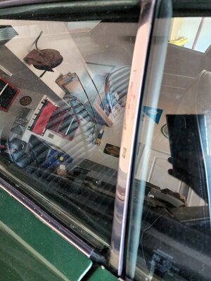

On a '71, Can the seals be replaced with the 1/4 window installed ? Do they slide out of the Stainless trim piece, ?
Yes, open the door, remove door jamb seal, remove screw in the bottom of the quater window seal, and it should slid down and out
Thank You for the Spot-On advice. I was on my way to replace them However the Metro seals (VS 7-F) I had are too short (About 3/4") They were Supposed to be correct for a '71.I hope to get this resolved with the vendor. So Old seal goes back on.IMG_20220918_130413018.jpg

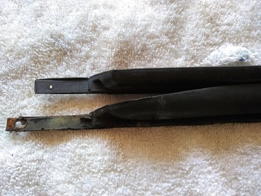

Here's my latest purchase, time to start putting those rear quarter windows back, picked these up from National Moparts here in Canada.
Removed the old seal, the new seal slides in and this little metal tab goes through the whole in the rubber seal. Used some silicone spray as the seal was a very tight fit; which of course you want.
As we know with most repro parts they are usually a little off, the hole that was drilled in the seal was out of place so I had to drill a new whole and it had to be a little more oval for the rubber seal to fit over it.
Finished product, I am very happy with it and glad it was available in the aftermarket, mine have always looked like crap.
I don't know of any repo seals that line up with the original screw hole. Just drill a new hole and install the screw. Unless this is a perfect resto, nobody will know and the new seals will keep water out.
