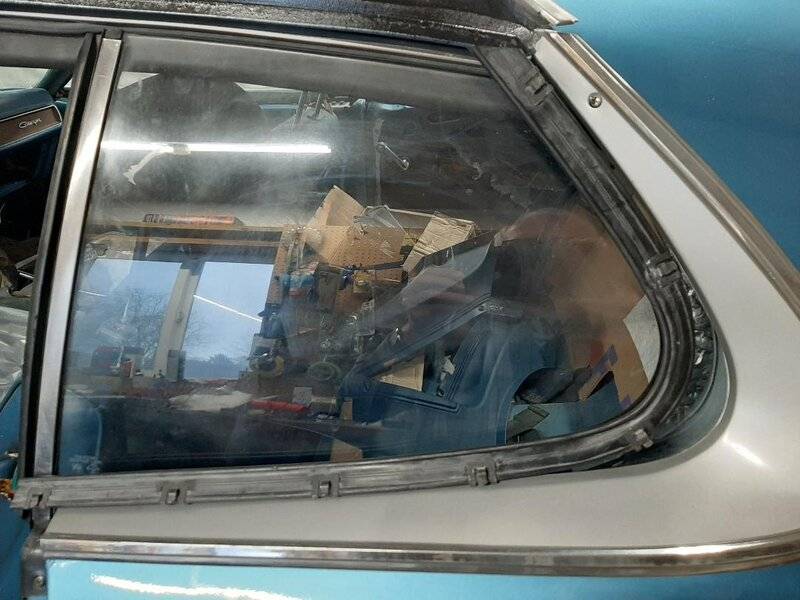

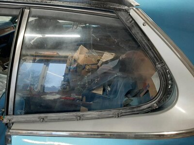

Detroit Muscle Technologies (DMT) is where I bought one set and Dantes is where I bought a second set. Now, I can't find any sets any where except DMT does have the SE sets listed as available on their website. That rear quarter sweep, both inner and outer were not easy to install. I had to elongate a couple of the slots by 1/8" to install the outer sweep with the correct curvature.

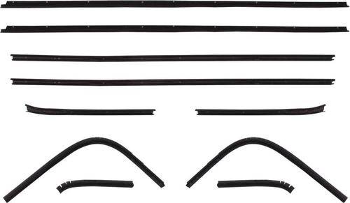

MM8286 - 1973-74 Plymouth B-Body 2 Door 10 Piece Door Glass Weatherstrip Set
Product #: MM8286
In Stock Now!
MSRP: $142.99 set
$129.99 set

I bought a set of the the Top Cat brand sweeps and a set of the PUI brand. The Top Cat brand is very close to the originals in shape. The only problem I had with them is the adhesive attaching the seal to the metal backing did not work well. I ended up redoing them with weatherstrip adhesive to keep them from coming apart. The PUI brand is a different shape of rubber seal from the original but will work. They were less expensive. Lessons learned: 1) take my time installing the sweeps. They aren't a perfect fit. 2) The glass tends to grab the new rubber when rolling window up. Go slowly and use a wide plastic body filler spreader to keep tucking the rubber seal down along glass to prevent pulling the rubber from separating from the steel backing. I thought about using a silicone spray on the glass but wasn't sure how it would affect the new sweep seal. 3) Leave the window rolled up for awhile to form the new sweep seal. If anyone has any other ideas or info, please share. It took me probably 10 hours to install both inner and outer sweeps. Thanks
Terry W.

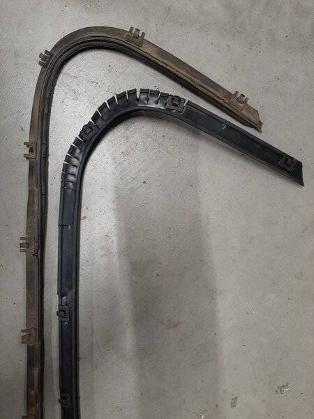

Here was the biggest difference as to how PUI sweeps make the corner bend. The one on the left is an original and PUI is on right. Top Cat brand was like the original. Maybe PUI has corrected this since I bought these a year ago.
Terry W.
That's a pretty big difference.
Yes but I will still use the PUI ones in another 74 Charger I have. As I said, I hope PUI has corrected this. My problem with the way they cut the hard part of the seal is that with age, will the split continue up into the part of the seal against the window. I don't know. I'm considering what I can use to fill in those gaps once installed. You can see the Top Cat ones in my first post in this topic in the first photo above of the sweep sitting in the window opening.

Maybe some sort of epoxy can be used after installation to beef it up.
