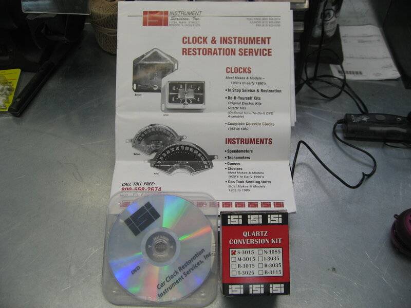

I contacted Instrument Specialties, they made a conversion kit for my 1969 standard, non-ralleye clock for $79 ( I think)... took me about 20 minutes to watch their video on their website and about an hour to install. I have the clock powered up and running on my workbench for about a week and it has kept perfect time.....very easy to do!
Here's the kit I used for my '66 Coronet. It's worked perfectly for several years now. Just follow the video, no problem.
I just dug through my car file and found the receipt for my 66-300. Mine is also the S-3015 unit, I paid a whooping $44 for it back in Feb. of 97. Tx & shipping totaled it to $55. Cheap stuff! Good Luck
Great - thanks guys. Looks like kit S-3015 from Instrument Specialties is what I need.
