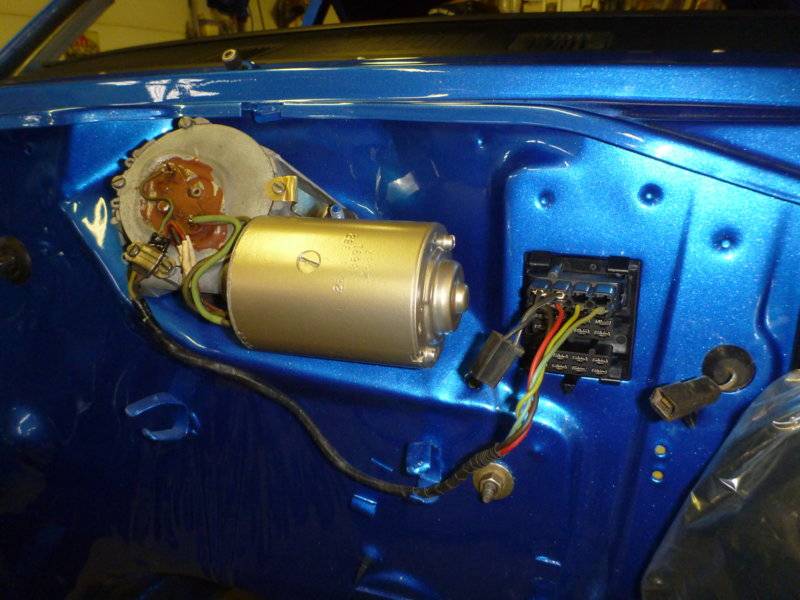

You can use the 2 speed.. I had one on my Bee since 1979. Now that I'm older and wiser I just recently fixed that "quick fix" from back in the day and made it right again! Buy a 3 speed wiper and the matching linkage arm + the three speed switch for the panel. The existing wiring in the dash harness has the extra brown wire you'll need on the switch. Make sure the motor you buy has the harness on it as it's different than the 2 speed.
